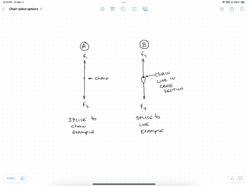

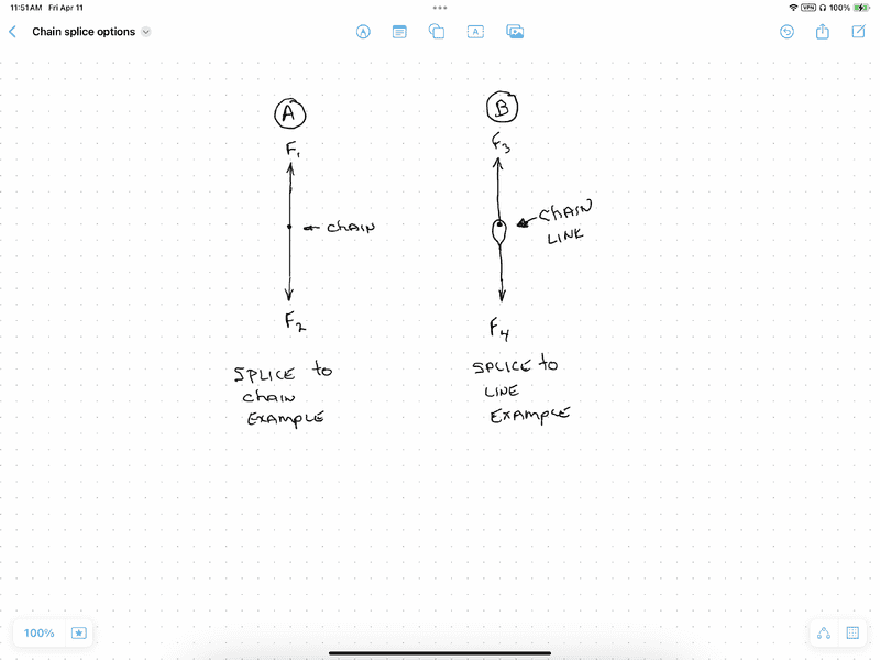

Thanks for your reply. I’ll restate the question but in much more simplified way such that this will be a theoretical question, not applying to real life.
Assume two designs, A and B as below. Assume a line with 1 strand instead of 3 strands. Assume all effects of a woven splice and bending effects are negligible. Design A is simply one strand of line spliced to a chain with a force diagram as in the picture showing F1=F2. Design B is also one strand but is wrapped around a chain link and spliced to itself where F3=F4. The question is: Is design B a better connection design than design A? Practically, it doesn’t matter since the strength of the line would control. Is design B splice stronger since there are effectively two strands supporting the force?
In real life, if design B splice is better, then except for bending effects, a three strand line spliced to a chain would be a better splice since, in the example given originally there are 4 strands supporting the force at the splice rather than 3 lines in design A.
A splice only works because of those effects. It relies on friction and finite stretching / distortion. There's been a lot of study of knots, ties and splices and you could always search those terms until you find something interesting / intelligible.
IMO the thing that counts is how many strands share the total load as they wrap over the link. The load on each strands would be F/n where F is the tension in the rope and n is the number of strands. It's seems obvious to me that the strongest arrangement will be with all strands passing through the steel link.
PS Your diagrams don't actually show any internal details of individual strands or a chain link. Probably a bit hard to know how to make a good diagram.. Most of what appears on the Web seems to be only loosely theoretical - only what riggers and practical rope users need to know.
