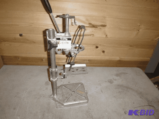

Hi i need a mechanism to lower the heater to certain height then it will automatically go up. It could be auto or manual hand mechanism. In short i need a mechanism which is installed in drill press table machine to lower drill bit. But in my scenario it is heater to seal small packaging of aluminium to plastic. Thanks in advance

You can buy drill press stands without the drill -- could you base your heater press on one of these?
https://www.k-bid.com/auction/5318/item/264

Hi Sir, Thanks for response.
Yes time will be variable depend upon at which material is being used. Heating element will be fixed at top side which will move up and down towards table. There will be minimum force apply to cut aluminium sheet and paste it on plastic cup. My main problem is which mechanism to use for lifting and lowering the whole mechanism.
