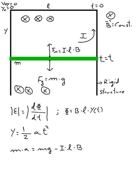

I am trying to solve a problem that I have invented.
It consists of a metal stick of mass m, which falls by the action of gravity (g=constant) within a perpendicular constant magnetic field B. The direction of magnetic fiel is showed in the image.
The stick makes electrical contact with a rigid metal structure. (view image).
This generates an intensity I(t) . And this intensity generates a force on the bar that according to Lenz's law is upwards (this is the big problem)
Initial positions and velocity are showed in the image. For easiest calculations they are Vo=0 and Yo=0.
$$|\varepsilon|=\left| \frac {d\Phi} {dt} \right|$$$$\Phi=B·l·y(t)$$$$y(t)=1/2·a(t)·t²$$
I use the Second Newton's Law: $$m·a=m·g-I(t)·l·B$$
for calculate the acceleration.
But I don't know if I need to know the value of the circuit resistance, of if I can solve it with the square loop induction coefficient L (Henrios). I need to calculate I(t) and I don't know how I can do it.

Your equation you got from applying Newton second law is correct. Have in mind that the acceleration a there relates to the velocity of the metal stick as ##a=\frac{dv}{dt}##.
Your equation for y(t) is correct only if acceleration is constant, otherwise it isn't correct. In any case, it would be better to use the ##E=Bv(t)l## formula for the emf produced, where ##v=v(t)=\frac{dy}{dt}## is the instantaneous velocity of the metal stick.​
What is another equation you can make by applying Kirchoff's Voltage Law for the square loop (give resistance ##R_s## to the stick and ##R_l## to its parallel piece of conductor)?
So at the end you ll have two equations (differential equations) with two unknowns, the velocity of the stick ##v(t##) and the current ##I(t)##.

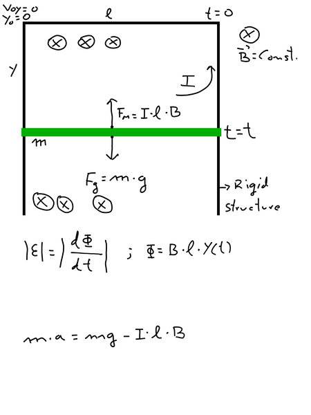

I suposse Ohm Law ##\varepsilon (t)=I(t)·(R_s + R_l)##. Rtotal is a constant, is simply R, I think.
Then I will re-upload the image by removing the wrong equation.
Ok. Thank you. I will try to solve it with your suggestions. This can take me some time.

Yes your equation is correct again.
I made a mistake in what I said in 1) in my first post, there will be a steady state in this problem which will prevent the stick from reaching too high velocities (unless it is starting with high initial velocity), if you are interested only for the steady state, you can find the current I for the steady state by setting a=0 in your 1st equation. Then from 2nd equation (ohms law as you said) you can find the velocity v of the steady state. (have in mind that E=Bvl)
If you are interested for the transient state, you got to solve the system of the two differential equations.
