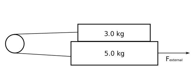

1. Homework Statement
A 3.0-kg block sits on top of a 5.0-kg block which is on a horizontal surface. The 5.0-kg block is pulled to the right with a force ##\vec{F}##. The coefficient of static friction between all surfaces is 0.63 and the kinetic coefficient is 0.38. What is the minimum value of F needed to move the two blocks?
##\|\vec{F}_{fs}\| = \mu_s \|\vec{N}\|##[/B]
##\sum F_{bottom} = F_{external} - T - F_{fb}##
## F_{fb} = \mu_s(m_{bottom}+m_{top})g + m_{top}g ##
##\sum F_{top} = T - F_{ft}##
## F_{ft} = \mu_sm_{top}g ##
## \sum F = F_{external} - T - F_{fb} + T - F_{ft} = F_{external} - F_{fb} - F_{ft} = 0 ##
## F_{external} = F_{fb} + F_{ft} = \mu_sg((m_{bottom}+m_{top}) + 2m_{top} )##
After plugging in all the numbers:
## F_{external} = 86N ##
86N is the right answer, but it seems odd to me because I essentially counted the friction between the two surfaces twice. Is it just the case that the frictional force between two surfaces moving across each other in opposite directions is twice that of when one of the surfaces isn't moving?
First off, a diagram would be most helpful. I was able to guess how things are arranged, but realize the only time you mention the pulley is in the thread title.
You used it twice only because the friction between the blocks acts on each block, and you analyzed each block separately.
No, why would you think that?
You are right. I added one.

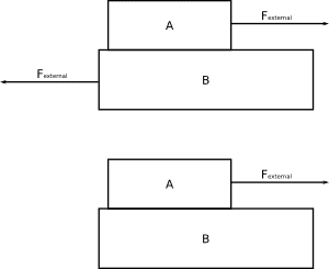

Does this mean that the forces of friction would cancel each other out if there wasn't a pulley, because they are equal and opposite? Edit: I'm thinking not because we analyse each block individually.
Also, when you say regardless of motion, what exactly do you mean?
Let's say that there is only the bottom block without the pulley. In this case, the friction between this block and the ground would be ##\mu_smg##. This is force of friction the ground exerts on the block, correct? Is there a force of friction that the block is exerting on the ground?
Edit: Maybe this will help with my original question.
Two diagrams of block A resting on block B. Top: F_external acts on A to the right and F_external acts on B to the left. Bottom: F_external acts on A to the right only, with B lying on the ground alone.
Is the total friction of these two cases the same, assuming the ground is frictionless in the top case? Maybe I shouldn't use the term friction. In other words, would the required force acting on the blocks to get A and B moving in the top case, and A moving in the bottom case, be the same?
Friction is governed by the relative motion of the surfaces.
One body can exert a force on another only if the other body exerts an equal and opposite reaction force. This applies to all forces, friction is no exception.
You can't push on something with force F unless it pushes back with an equal opposing force. Try it.
