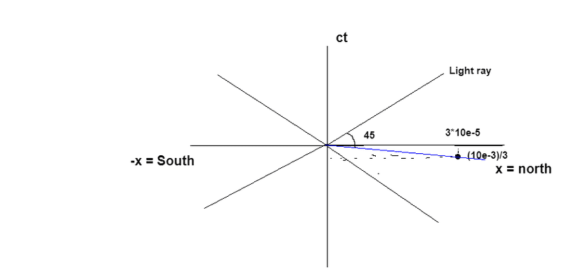

At t=0 A is moving
At t = -1/3 ms B is at 300km north and send a light beam
Draw the Minkowski diagram then tell if the light beam will reach A
##-\frac{1}{3} ms = -\frac{10^{-3}}{3}s##
##300km = 3\cdot10^5 m##
##ct = -\frac{10^{-3}}{3}s \cdot c##
I drew the Minkowski diagram, but I'm not sure if this is correct.
From what I drew the angle between x and ct ##\approx 0##
then the event is "inside" the light ray and will eventually reach A.
Minkowski diagram with ct on the vertical axis and x on the horizontal axis, x = north to the right and -x = South to the left, with a light ray at 45 degrees and a blue line to a point labelled (10e-3)/3 at 3*10e-5.

I'm wondering if I should have draw the cone of light instead of the diagram above?
Thus, since opposite/adjacent < 1, the event in inside the cone of light and if the event in inside the cone of light, the light signal will eventually reach A. Is it correct?
Edit: Since ##ct = 300000000 \cdot -\frac{10^{-3}}{3} = 100000m##
And ##100000/300000 < 1## this is not inside the cone of light, so it will not reach A.
