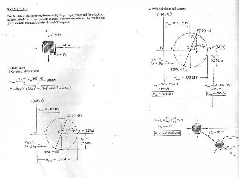

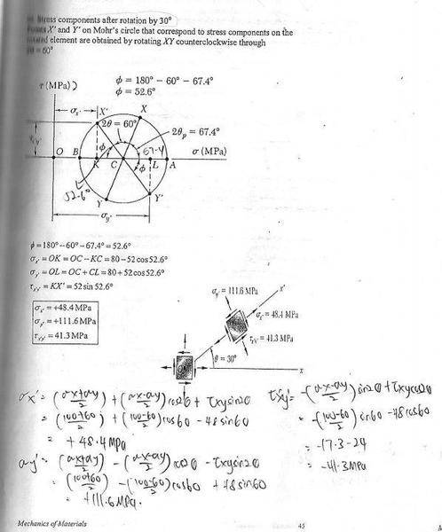

for the τx'y' , i use the formula of -0.5(σx - σy)sin2θ + τxycos2θ , i found the ans is -41.3 rather than positive 41.3 , which part of my working is wrong? or I misunderstood something?
  • Two-panel textbook page showing Mohr's circle solution for Example 1.15: left panel constructs the circle with X(100, 48) and Y(60, -48), centre 80 MPa, radius 52 MPa; right panel shows principal stresses 132 MPa and 28 MPa and rotation angle 33.7 degrees.

  • Handwritten stress transformation working on a notebook page, with a Mohr's circle diagram above showing sigma x, sigma y and tau xy and rotated axes x' and y' at 30 degrees.

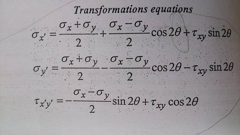

here's the formula:
  • Handwritten-style page titled Transformations equations showing three stress transformation formulas: sigma x prime, sigma y prime, and tau x prime y prime in terms of sigma x, sigma y, tau xy and theta, with 2 theta in the trigonometric terms.

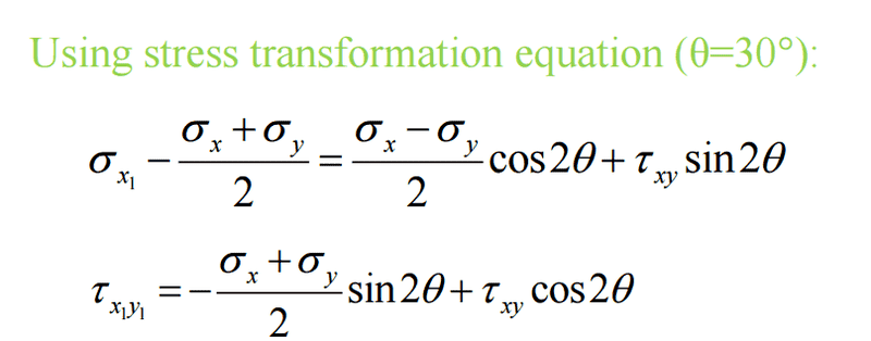

after checking many times, I still couldn't find out the mistake
or it's wrong to use the transformation equation to do this question?

no, i don't think i can find the answer for this question in other thread,can you help?
I have also used sin2(-θ) and cos2(-θ) instead of sin2(θ) and cos2(θ), but i still couldn't find the answer same as the author , which part of my working goes wrong
