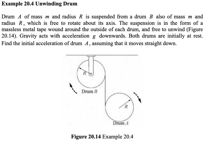

I'm self-studying MIT OCW's 8.01, Introduction to Classical Mechanics Course. I am on the final week, where the topic is translational and rotational motion. I was following along the course notes and reached an example which I'd like to dive a bit deeper into, but I am not sure how.
The problem is Example 20.4 in the notes if you want to see it directly. I will reproduce it here:
The example itself is only asking for the relationship between the angular accelerations and the linear acceleration of drum A. To find the answer it is straightforward:
The metal tape connecting the drums has a fixed total length. Whatever increase in the length between the drums is due to unrolling of A and unrolling of B. The increase in length between the drums is also the displacement of the center of mass of A. Therefore
$$\Delta y = R \Delta \theta_B + R \Delta \theta_A$$
Dividing by ##\Delta t## and taking the limit as ##\Delta t \to 0## we get
$$\frac{dy}{dt}=R(\alpha_A +\alpha_B)$$
That is intuitively clear, and that is the answer to this particular question. But what about finding the actual tension force or the angular accelerations of each drum?
In particular, the system of drums starts with zero momentum and angular momentum. There are no external torques, only the internal torque applied by the tape on each of the drums. The first question is: we need to calculate torques and angular momentums always relative to the same origin, correct?

Shouldn't the ##\alpha##'s be ##\omega##'s? You'll need to take another time derivative to get an equation involving ##\ddot y##, ##\alpha_A## and ##\alpha_B##.
If you want to use the general relation ## \large \vec \tau^{\rm ext} = \frac{d \vec L}{dt}## for some chosen system, then the torques and angular momentum should be calculated relative to the same origin.
For the system consisting of both drums and the metal tape, and choosing the origin at the center of ##B##, the net external torque will not be zero. (Consider the force of gravity acting on drum ##A##.) So, angular momentum about this origin will not be conserved. But, you could set up ## \large \vec \tau^{\rm ext} = \frac{d \vec L}{dt}##if you want.
It is not necessary to use angular momentum concepts for this problem. You should be able to solve it using ##F = ma## and ##\tau = I \alpha## applied to each drum separately along with your kinematic equation that relates ##\ddot y##, ##\alpha_A##, and ##\alpha_B##.

You are right, it was a typo on my part. The correct equation is
$$\dot{y}=R(\omega_A+\omega_B)$$
$$\ddot{y}=R(\alpha_A+\alpha_B)$$
You are also correct that the gravitational force on drum A applies a torque to the system about the center of mass of B.
$$\vec{\tau}_{cm_B,B,f}=R\hat{i} \times T \hat{j} = RT \hat{k}$$
$$\vec{\tau}_{cm_B,A,f}=(2R \hat{i}+l\hat{j}) \times mg \hat{j}=(2Rmg-RT)\hat{k}$$
$$\implies \vec{\tau}_{cm_B,sys,f}= 2Rmg \hat{k}$$
So indeed the torque of the system about ##cm_B## is not zero.
Now I will try the approach you suggested as I understood it:
Drum B
##2^{nd}## Law:
$$mg+T-N=0$$
Torque: $$\vec{\tau}_{cm_B,B,f}=R\hat{i} \times T \hat{j} = RT \hat{k}$$
$$\implies RT=I_{cm_B,B}\alpha_B$$
Drum A
##2^{nd}## Law:
$$mg-T=ma_A$$
Torque: $$\vec{\tau}_{cm_A,A,f}=-R\hat{i} \times (-T \hat{j})=RT\hat{k}$$
$$\implies RT=I_{cm_A,A}\alpha_A$$
So all the equations together looks like:
$$a_A=R(\alpha_A+\alpha_B)\tag{1}$$
$$mg+T-N=0\tag{2}$$
$$RT=I_{cm_B,B}\alpha_B\tag{3}$$
$$RT=I_{cm_A,A}\alpha_A\tag{4}$$
$$mg-T=ma_A\tag{5}$$
Here we have five equations and five unknowns: ##a_A##, ##\alpha_A##, ##\alpha_B##, ##T##, ##N##.
If we assume that the moments of inertia are the same and equal to ##I##, from ##(3)## and ##(4)## we get that $$\alpha_A=\alpha_B=\alpha$$
$$\alpha=\frac{RT}{I}$$
Substitute in the equation for ##T## results in
$$T=\frac{mgI}{I+2R^2m}$$
$$\alpha=\frac{mgR}{I+2R^2m}$$
$$a_A=\frac{2mgR^2}{I+2R^2m}$$
$$N=\frac{2mg(I+R^2m)}{I+2R^2m}$$

Very nice solution and analysis. If you like, you can check that ##\large \vec \tau^{ext} = \frac{d \vec L}{dt} ## for the system as a whole with the origin chosen at the center of B. Here ##\vec L## is the total angular momentum of the system about the origin.

We can now check the angular momentum of the system
$$\vec{L}_{cm_B,B}=\frac{mR^2}{2}\frac{2gt}{5R}\hat{k}=\frac{Rgmt}{5}\hat{k}\tag{1}$$
$$\vec{L}_{cm_B,A}=\vec{L}_{cm_B, cm_A} +\vec{L}_{cm_A,A}\tag{2}$$
In ##(2)## I used the relationship that says that the angular momentum of a system of particles about ##cm_B## is the angular moment of the center of mass of the system about ##cm_B## plus the angular momentum of the particles about the center of mass of the system of particles. In this case the system of particles is the rigid body drum A.
$$\implies \vec{L}_{cm_B,A}=(2R\hat{i}+l \hat{j}) \times m \frac{4gt}{5} \hat{j} + \frac{mR^2}{2} \frac{2gt}{5R} \hat{k}=\frac{Rgmt}{5} \hat{k}$$
$$\implies \vec{L}_{cm_B,sys}=2Rgmt \hat{k}$$
$$\frac{d\vec{L}_{cm_B}}{dt}=2Rgmt \hat{k} = \vec{\tau}_{cm_B,sys}$$
This value of ##\vec{\tau}_{cm_B,sys}## agrees with the value calculated initially by calculating the torque on each individual drum.
That looks very good. I noticed a couple of typographical errors:
In the first equation above, the far right-hand side is missing a factor of 9. But the second equation is correct.
The ##t## in the expression after the first equal sign should not be there.
Good. You only need to consider external torques acting on the system. The only external force that contributes a torque about the cm of B is the force of gravity on A. This force has a lever arm of 2R. So, ##\vec{\tau}_{cm_B,sys} = 2Rmg \hat{k}##
