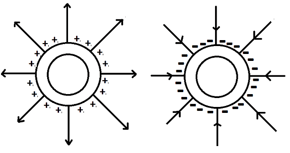

I have a question to the solutions
a) They constructed a bigger cylinder for their Gaussian surface. Now my question is, is the thin cylindrical shell itself a charge and that is why we must construct our own surface?
What happens if the [tex]\vec{E}[/tex] field is 36kN/C at 7.00cm?
b) Why is it 0? Why can't you just replace 19cm with 4.00cm?
Because according to gauss law, flux or even E is directly disproportional to charge in-closed by the surface.

flyingpig said:
But it doesn't mean it can't right?
No there can't be any field ... you know that charges on conductor resides on surfaces ...most probably on outer to reduce its potential energy
so draw the figure of cylindrical shell we're talking about ... draw charge on outer surface ... and you see there is no charge inside to provide electric field! the outer charge provides field to outer area. This concept in electrostatic shielding

Wait, is it because the radial E-field outside the surface of the shell?
Look at the pic
If charge is + or -, E will be outside the area,
you think there will be field inside too. can you tell me why?
