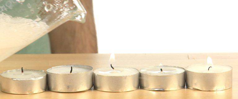

We don't get smothered by CO2 or SO2 because the atmo is constantly being stirred up. Inside a closed space such as a balloon, the gases may initially diffuse, but if left long enough without disturbance, I think they should separate - like CO2 in a tank - even an open-topped tank - will pool at the bottom.

...CO2 in a tank - even an open-topped tank - will pool at the bottom.
I don't think that's true unless you have a very liberal definition of "pool" or a really tall tank. I believe that significant separation occurs on a scale of tens of kilometers.
No. It literally is done in an aquarium. You put candles on the bottom, and pour in CO2. It pools on the bottom. Candles set several inches higher do not get snuffed out.
It's a common lab demo.
This one uses both candles and bubbles.

The reason that CO2 pools in say, fermentation tanks (very dangerously!) is not because it settles out, but because it was generated there. Leave your tank open for long enough, and it equilibrates with the atmosphere. Pour a mix of air and CO2 into your tank, and it remains a mix from now until the Big Crunch, as long as you do not freeze out the CO2 as dry ice (or liquid CO2 if the pressure is high enough!)
So, lab demos where people are pouring CO2 out of a beaker over a candle to snuff it out are ... what?
DaveC426913 said:
So, videos where people are pouring CO2 out of a beaker over a candle to snuff it out are ... what?
Irrelevant.
The claim was that gravity trumps diffusion and leaves as a result a stratified arrangement. The fact is otherwise. The supposed demonstration otherwise is irrelevant. It only serves to demonstrate that diffusion is not immediate.
That is not to say that stratification does not occur. However it is not relevant in room or acquarium-sized settings. Here is a link.
They are the pouring of bulk cold CO2; try it on warm CO2 someday :biggrin:
Remember what I said about buoyancy being a bulk effect.
If you make it cold and plentiful enough, you could get the same effect with nitrogen,
and remember that N2 is marginally less dense than air at the same temperature and pressure.
OK I see the nuances.
I was thinking that gases starting off mixed would eventually stratify.
It seems that gases will diffuse - even if they start off stratified, for whatever reason.
