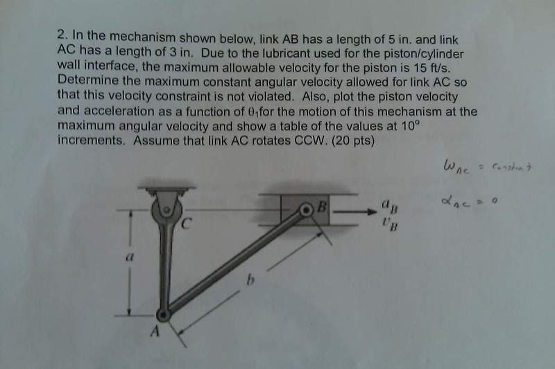

I would like to know if my work is correct. I thought that the graph would be a sinusoidal, but there is a small irregularity in the middle.
Am I correct in using θAC = 90 deg and θAB = 36.8699 deg in solving for the constant angular velocity?

What concerned me about using θAC = 90 deg is that it causes θ'AB = 0 due to the cos term. This ends up making the max angular velocity -60 rad/s...
