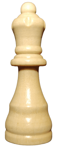

Need a way to calculate a loss in volume if an object has indents of unknown shape.

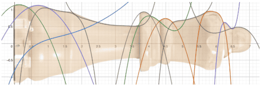

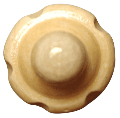

I'm modelling an object with functions to get its volume. I've laid it along the x-axis lengthwise, to scale, and have functions that model its curvature well. I can calculate the gross volume with the solid of revolution integrals, but there's one section with 'indents' and I have no idea how to account for this. The section in question is the one modelled by the third function from the right in the graph image. I've taken a top-down image of the object, is that at all useful? It looks somewhat like a cylindrical indent, but the indent might not be completely parallel to the x-axis.

The black curve at the tip appears to need some fine tuning.
As for the "nicks", it looks like something with a donut shaped profile intersecting with your red curve would create something like it.

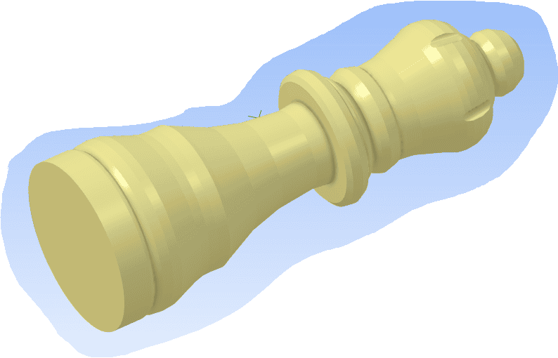

I created the part by tracing the profile and revolving.

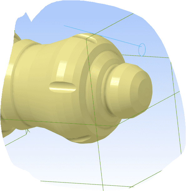

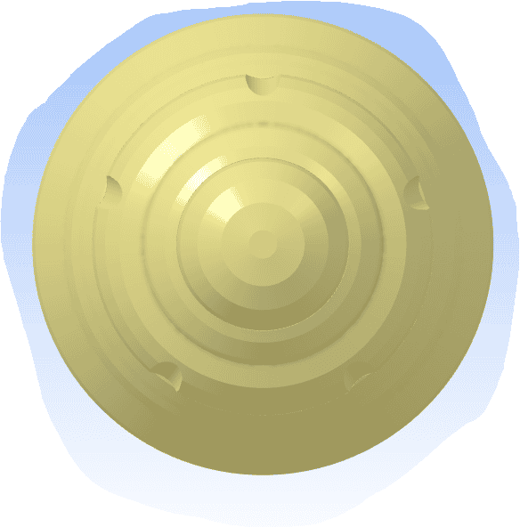

These "nicks" were created in the 3D model you see here by sweep cutting a circle along an inclined path, and then pattern radially. Where it intersects with your surface of revolution the material is removed. I have severe doubt it would be trivial to compute this process algebraically. If you are trying to use mathematics, then you need to figure out how to describe this from the geometry... So intersection of an oblique cylinder with your solid of revolution.

How are we supposed to know what shape those indents make? We'd need their function in all three dimensions. Is the indent cylindrical? spherical? Does the maximum radius of the cutout align with the maximum radius of the lip? There are innumerable parameters that have to be defined before you can even begin arranging them in formulae.
Your top view makes it very apparent that we have no idea the shape or position of the cutout. Cylinder? Sphere? Blob? Above equator? By how much?
