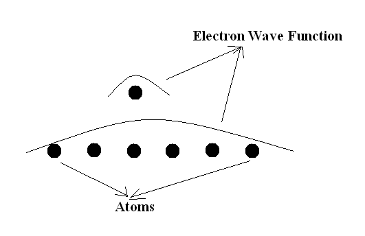

you can look it from this point of view that metals are favorable state (in respect to energy) because the electron wave function can expand all over the metal and momentum is inverse of wavelength so momentum decreases and as a result the energy decreases. The same thing is true for crystal creation but when you increase the temperature the Entropy comes in and no longer crystal structure would be favorable (Concept of free energy ...).
Aside from my main question, which I still don't think has been answered, I don't understand why the larger orbital space in a molecule decreases an electron's momentum (and hence, energy). I understand the inverse relation of position and momentum due to the uncertainty principle, but how is a decrease in the CERTAINTY of the electron's momentum the same as a decrease in its momentum itself? It just means we have less knowledge of what it is, not necessarily that it's actually less.

In a single atom the wave function of electron is confined to a region near it so the wavelength of electron is short hence its momentum is high. when you have a metal, there exists many states which their wavelength are near metal's width, so their wavelength are very larger in compare to a single atom and their momentum are very smaller.
