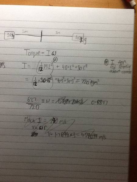

My workings are below :
Following the calculation of w I use v=wr where r= 3 and calculate the tangential velocity.
It's then easy to see that a speed of 340 (Mach 1) will be attained in 128 s
Is this correct ?
In your handwritten working, you've written omega instead of omega-dot, but otherwise it all looks correct.
I don't understand you. Torque = Iw , correct ?
No, it is
τ = Iα
where α is the angular acceleration
hms.tech said:
No, it is
τ = Iα
... and although the OP says "I use v=wr ", what has actually been used is a = αr.
