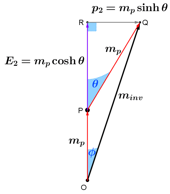

An even simpler method comes from drawing an energy-momentum diagram and doing some trigonometry.
This is equivalent to @PeroK 's calculation.
If you can add vectors and do some trig for a free-body diagram, you can do this:
We add two proton 4-momentum vectors [itex]\tilde p_1[/itex] and [itex]\tilde p_2[/itex],
one at rest and the other with nonzero velocity in this frame. Each has magnitude equal to the proton-rest-mass [itex]m_p[/itex].
The sum of these 4-momenta is the 4-momentum of the system, which has magnitude [itex]m_{inv}[/itex], called the invariant mass.
(By the way, this is an isosceles triangle in energy-momentum space.)
Using rapidity, where [itex]v=\tanh\theta[/itex] so that [itex]\gamma=\cosh\theta[/itex] and [itex]\gamma v =\sinh\theta[/itex] ...
In this lab frame, the "high-energy proton" has energy [itex]E_2=m_p\cosh\theta = \gamma m_p[/itex] and spatial momentum [itex]p_2=m_p\sinh\theta =\gamma m_p v[/itex].
So, the magnitude of [itex]\tilde p_1 + \tilde p_2[/itex] is
[tex] \begin{align*}<br /> m_{inv}=|\tilde p_1 + \tilde p_2|<br /> &=\sqrt{ (\tilde p_1 +\tilde p_2) \cdot (\tilde p_1 +\tilde p_2) } \\<br /> &=\sqrt{ (E_1 + E_2)^2 - (p_1 + p_2)^2 } \\<br /> &=\sqrt{ (m _p + m_p\cosh\theta)^2 - (0 + m_p\sinh\theta)^2 } \\<br /> &=m_p\sqrt{ (1 + \cosh\theta)^2 - (0 + \sinh\theta)^2 } \\<br /> \end{align*}[/tex]
With [itex]m_p=0.938[/itex] and [itex]E_2=76.4[/itex],
we have
[itex]\cosh\theta =\displaystyle \frac{adj}{hyp}=\frac{ 76.4}{0.938}[/itex].
  • You can solve for [itex]\theta=\texttt{arccosh(76.4/0.938)}=5.09...[/itex]
    so that [itex]\sinh\theta=\texttt{sinh(arccosh(76.4/0.938))}= 81.44...[/itex]
    Thus, [itex]m_{inv}=m_p \texttt{ sqrt((1+(76.4/0.938))^2-sinh(arccosh(76.4/0.938))^2)}=(12.84...)m_p[/itex]
or
  • You can use some identities:
    [itex]\cosh^2\theta-\sinh^2\theta = 1[/itex] implies
    [itex]\sinh^2\theta=\cosh^2\theta - 1[/itex].
    So,
    [itex]\begin{align*}<br /> m_{inv}<br /> &=m_p\sqrt{ (1 + \cosh\theta)^2 - (\cosh^2\theta - 1)}\\<br /> &=m_p\sqrt{ 2+ 2\cosh\theta}\\<br /> &=m_p\sqrt{ 2\left(1+ \frac{ 76.4}{0.938}\right) }\\<br /> &=m_p\texttt{ sqrt(2(1+(76.4/0.938)))}=(12.84..)m_p<br /> \end{align*}[/itex]
No need to boost into the center-of-momentum frame.

  • You can also use the law of cosines.
    [itex]\begin{align*}<br /> \tilde P&= \tilde p_1 + \tilde p_2\\<br /> \tilde P^2&= \tilde p_1{}^2 + \tilde p_2{}^2 + 2\tilde p_1\cdot \tilde p_2 \\<br /> m_{inv}^2<br /> &= m_p^2 + m_p^2 + 2m_p m_p\cosh\theta \qquad \mbox{we use the external angle}\\<br /> &= m_p^2\ 2(1+ \cosh\theta) \\<br /> \end{align*}[/itex]
