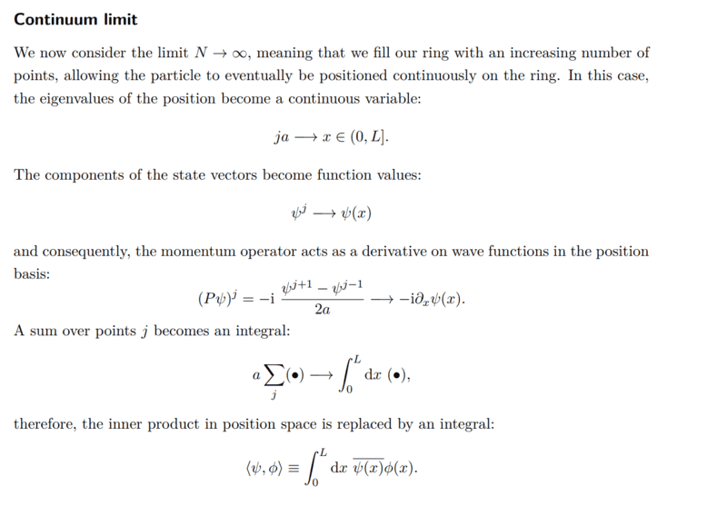

To solve task g, we have received the following information
Typeset lecture notes titled Continuum limit: the limit N to infinity gives position eigenvalues ja to x in (0, L], components become function values psi(x), the momentum operator becomes -i d/dx, sums become integrals, and the inner product becomes an integral.
Task g
Typed text part f: Suppose our particle is in the state psi_0(x) = 1/sqrt(L), where momentum is uniquely determined by k = 0, and asks what this state implies about the probabilities of finding the particle.
If I understood the task correctly, then the wave function is collapsed, to the eigenvector of the momentum operator, more precisely to ##\psi_0##. The wave function has with 100% the eigenvalue of ##\psi_0## after the uncertainty principle, the uncertainty would have to become extremely large concerning the position, which means that the particle can be everywhere on the ring and thus the probability for each position is equally large.
