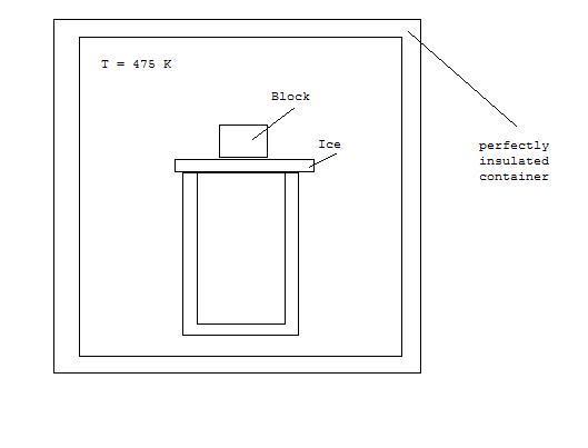

What would happen if I took a glass of icewater and put it in an well-insulated box full of warm air? The system would be isolated, but you'd have quite a hard time convincing me that the glass would be exactly the same if I took it out after a few hours.

Okay, consider the picture below:
There is a block of some material placed atop a chunk of ice that prevents the block from falling into the cup. The temperature of the air in the box is much higher than the melting point of ice. We assume the box is well-insulated, so there is no heat transfer with the surroundings.
What happens to the ice as time goes on?
