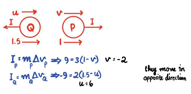

Two particles P and Q of masses 3 kg and 2 kg respectively are moving along the same straight line on a smooth horizontal surface. The particles collide. After the collision both the particles are moving in the same direction, the speed of P is 1 m/s and the speed of Q is 1.5 m/s. The magnitude of the impulse of P on Q is 9N s. Find:
a) Speed and direction of P before the collision
b) Speed and direction of Q before the collision
I=m(v-u)
Pf=Pi
Hi
I've tried solving this question but it seems that I flipped the direction of the impulse, what did I interpret wrong? the question didn't give any clue on their direction before so I couldn't infer the direction of the impulse. It also just gave me the magnitude without the direction. I would appreciate if you could help me know why is my diagram wrong.
If after two particles collide they are moving in the same direction, which is moving faster, the one in the lead or the one behind?
Oh, i just realized! how couldn't I be logical in the first place ;(. Thanks a ton haruspex!
Your equations would yield the same results as those of book (with the roles of u,v swapped) , if you change the sign of impulse in each one, that is if you had the equations $$-9=3(1-v)$$$$9=2(1.5-u)$$.
However I am confused too why we should consider the impulse as negative in the first equation with v , and as positive in the second equation with u.

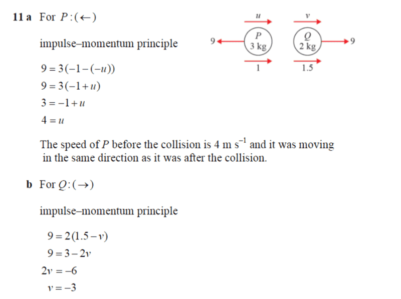

In the official answer (shown in Post #1), it looks like the author has mixed sign conventions:
- for P, they have taken the positive direction to be same as the direction of the impulse acting on P (to the left);
- for Q, they have taken the positive direction to be same as the direction of the impulse acting on Q (to the right).
Very silly and/or a bit of a bodge (IMO)!
(Also note, in the official answer, ‘u’ is P’s initial velocity and ‘v’ is Q’s initial velocity. That seems logical - based on alphabetical ordering.)
A more sensible approach to the sign convention would be to use the known common direction of the final velocities as the reference. Take it to be the +x direction (to the right).
The final velocities of P and Q are then both positive (+1m/s and +1.5m/s).
It is not hard to deduce that the impulse of Q on P must have been negative (-9Ns) and the impulse of P on Q must have been positive (+9Ns).
We then get:
For P: -9 = 3(1-u) ⇒ u = 4m/s
For Q: +9 = 2(1.5 – v) ⇒ v = -3m/s

Following the book's bad example and ignoring units, I would say.
Q has momentum ##+3## after the collision and was given an impulse of ##+9## so must have had a momentum of ##-6## before the collision.
P has momentum ##3## after an impulse of ##-9## so must have had ##12##.
It seems logical to me use momentum rather than velocity. And then get the velocity from the momentum.
