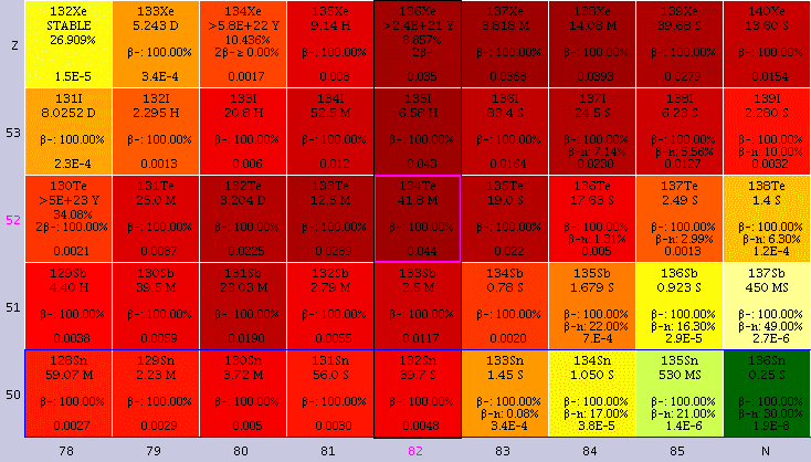

Anyone on this forum know what the highest-probability fission chain reaction of plutonium-239 is?

Are you looking for fission product yield? If so you can see a plot http://www.nndc.bnl.gov/sigma/getFissionYieldsPlot.jsp?submit=Update+Plot&ymin=3.737E-19&ymax=6.084E-2&yscale=lin&ylimits=auto&energy=0&zplot=24&zplot=25&zplot=26&zplot=27&zplot=28&zplot=29&zplot=30&zplot=31&zplot=32&zplot=33&zplot=34&zplot=35&zplot=36&zplot=37&zplot=38&zplot=39&zplot=40&zplot=41&zplot=42&zplot=43&zplot=44&zplot=45&zplot=46&zplot=47&zplot=48&zplot=49&zplot=50&zplot=51&zplot=52&zplot=53&zplot=54&zplot=55&zplot=56&zplot=57&zplot=58&zplot=59&zplot=60&zplot=61&zplot=62&zplot=63&zplot=64&zplot=65&zplot=66&zplot=67&zplot=68&zplot=69&zplot=70&evalid=4615&mf=8&mt=454" .

No. I want to know what the most likely IMMEDIATE fission products are. I.e., what are the two large nuclei that are immediately produced by the fission of a Pu-239 nucleus most likely to be? Surely someone somewhere knows the answer ... I'm just amazed that the answer isn't easy to find on the web.
Usually, those two initial large nuclei are very unstable, with half-lives in minutes, seconds, or even less. They will then decay into longer-lived nuclei, as time passes after the explosion.
I didn't find any of those "yield charts" on the web to be useful, because they seem to be mostly concerned with the eventual longer-lived products. That's probably because the issues that usually are motivating those charts are issues of the health effects of nuclear reactions, or issues of nuclear reactor design, or of issues of spent-fuel-rod disposal. The extremely short-lived initial products don't exist long enough to be important in those issues.

The link I posted is direct fission product yields, not cumulative yields. For example, the highest yield isotope indicated is Zr-100 which has a half-life of 7 seconds.

I looked at your chart again, but I couldn't tell what the highest-probability REACTION was. The chart does show that the most likely smaller nucleus is 40_Zr_100, but what is the larger nucleus in that reaction? The chart says that the most likely larger nucleus is 52_Te_134, but I doubt that the most likely reaction produces those two nuclei (because I THINK that the initial reaction won't involve the conversion of any protons ... so Z will be conserved).
Is there a way to tell from that chart which initial REACTION is the most probable? That's what I'm looking for.

If one goes to the chart of nuclides (as indicated by QuantumPion), and selects 239Pu FY and uses Zoom 1, then one will see the yields. The highest yield is 40Zr100 (at 0.048) and its complement 52Te134 (at 0.044). Two fission (prompt) neutrons would also be emitted.
The proton number Z is preserved 40 + 52 = 92 and 100 + 134 + 2n = 236 = 235 + 1n

Remember we are starting with Z=94 and A=239 (240 with incident neutron) not U-235. So Te-134 cannot be the compliment (unless there is a third fission product consisting of an He-6 nucleus, which does happen to have a positive Q value although I don't know if that reaction actually can occur).
According to the http://www.nndc.bnl.gov/qcalc/" the complimenting fragment of Zr-100 is Xe-140 and the compliment of Te-134 is Mo-106 (Type in Pu139 for the target, n for the projectile, and anything for the ejectile).
