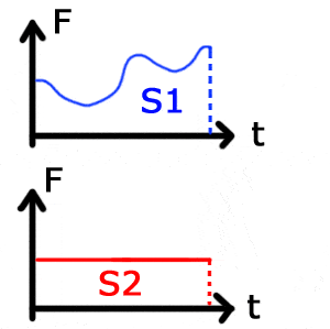

Zula110100100 said:
Equation 3 from that source points out that a linear impulse is equal to change in linear acceleration
If we take an force of 6.2N over 10.9 seconds, that is an impulse of 67.58N*s
This means we must see a change in momentum of 67.58kg*m/s The weight presumably started at a velocity of 0, so this means it is left with a velocity of .4m/s, thus, it has not yet stopped moving, if you stop applying force, it will take gravity another .04s to stop it, and during that time there is a negative propulsive force, an applied force less than the force required to hold the object up.
So in my opinion the data is not good, because they did not wait for it to stop to take their readings.
If you take 1672.2N(the applied force required to get a propulsive force of 6.2N) * 10.9+ 0N*.04s = 1672.2 and then divide that by the total time 10.94 = 1666.0859N avg which is really close to the 1666N that were required to hold it up.
For the faster rep, we have an avg propulsive force of 45.3N * 2.8s = 126.8N*s, so we know it is left with a velocity of .75m/s which would take gravity .076s to decelerate, so again, add the 45.3 to 1666 = 1711.3*2.8s = 4791.64N*s from the force applied
+0n*.076s =4791.64/(2.8+.076) = 1666.078 once again really close to the force required to hold it still in the first place.
So overall, sure, it is more force to get the same weight going faster, anyone will agree there, the problem is that unless you apply a force to pull the weight down toward you before it stop moving up, then comparing the force for the whole cycle should be the same
in other words, if you apply more than required to hold it up, and then never less than required to hold it up, it will keep moving up, since that is not the case there is more going on than listed in that expiriment

it would register far far far more.
So it would take more force to lift the same weight up and down on the second moving rep, than to just move it up and down from a still start.
The process that causes it to register more is the "force-applied" impulse being shorter time, more force(higher reading), but this will still be equal to the impulse of gravity if you average in the time that no force was applied. Just before it is moving up again, it IS at a still start again. Any extra force applied to "get it going back up" from downward motion can be split between stopping it and starting again. The "stopping it part" is part of the downward rep.

Wayne

If the weight and time were the same, and they started and ended at v=0, then the force-applied impulses are the same in each. This shows that Average muscle activation does not directly correlate to fore-applied impulse. Do the same thing with different amounts of weight, each held for the same time, in the same position.
Also, is not power in mechanics, the combination of forces and movement ? I thought power was the product of a force on an object and the object's velocity ? As we all will agree that the fast uses more power, {even I can work that out with some simple equations} so if power is the of a force on an object and the object's velocity, does that not mean more force more power ?
Lets say we have a force of 1N, we apply that force at two velocities, one is 12m in 6s = 2m/s the other is 2m in 6 seconds = .33m/s, the power is 2(1) = 2watts for the fast one, and .33(1) .33watts for the slow one. The same force, different velocities.
