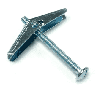

SaiQmon said:
Some locations have plasterboard walls. Board itself will handle this load, but mounting screws can take only 0.15kN / each for plasterboard.
Be careful. Unless the screws go into the wood studs behind the plasterboard, this is risky. Are you using anchor screws like this?
I have put screws into plasterboard. A particular screw, perfectly installed in exactly the correct size hole, may hold the rated 150 N if the load is perfectly applied. In the real world, expect an occasional failure. I would want to see screws at least 25 mm into a wood stud, or the anchor shown by @anorlunda. That goes double if you have drunken engineers in the area.
