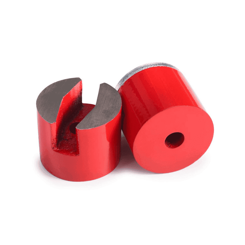

To minimize potential problems, just be sure to use a magnet that has a closed magnetic path when attached to the ferrous metal surface. Horseshoe magnets (regular or cylindrical) have this property, for example.
BTW, not many walls have ferrous metal in them (unless this application is for a ship). Are you intending to attach this detector to some metal appliance like a refrigerator or dishwasher?
Cylindrical Horseshoe Magnet:
https://www.imagnetshop.com/661-large_default/19-ima731.jpg

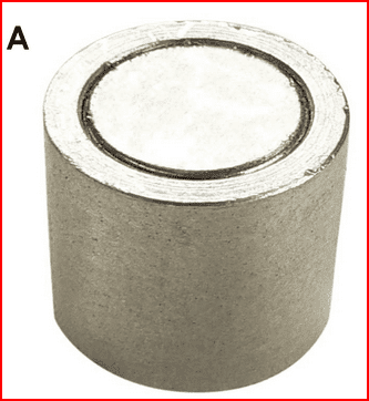

I was actually intending to use a flat cylindrical magnet, but didn't know that it would minimize potential problems. Could you please elaborate on this, explaining me what pro's and con's there would be using a "normal" magnet to a cylindrical one?

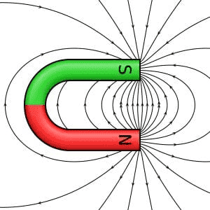

The important point is that the magnetic field be confined to the magnet and the ferrous plate it is stuck to, and that the external fringe field is very small. If there are any inductive components in your circuit (inductors, cores, etc.) that use ferrite in their construction, external stray DC magnetic fields can alter their performance and potentially cause the circuit to not work well or fail altogether.
Horseshoe shaped magnets have such a property when they are attached to a ferrous surface. "Horseshoe" magnets come in different configurations, from the traditional U-shaped version to the cylindrical version that I posted a picture of. You can also get cylindrical magnets where the two poles are coaxial, with a center pole surrounded by a peripheral pole:
https://www.magnetics.com/product.asp?ProductID=42
While a "horseshoe" type magnet is not attached to anything, there are still stray fields that can interfere with the operation of inductive circuits that contain ferrite. I don't know if that's an issue in your appliation or not. One solution to that is to add a "keeper" piece of ferrous metal that attaches to the magnet on the product when it is not mounted on anything.

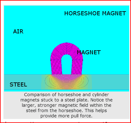

Field when not attached to anything:
https://cpb-us-e1.wpmucdn.com/sites...5/hsmagnet-142sair-e1547587903347-300x300.jpg
Field when attached to ferrous metal:
https://www.kjmagnetics.com/blog.asp?p=why-horseshoes

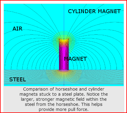

Compared to the external stray field of a regular bar magnet (yikes!):
