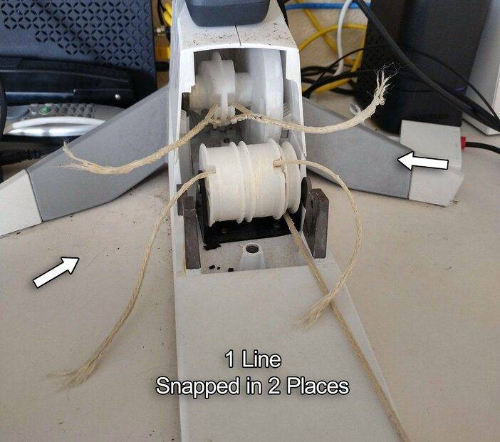

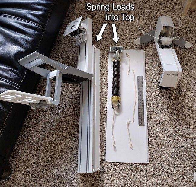

A Stand/Sit workstation is tensioned by internal nylon ropes. When one breaks, the internal spring snaps back into a rest state. But how did one rope break in two places simultaneously?

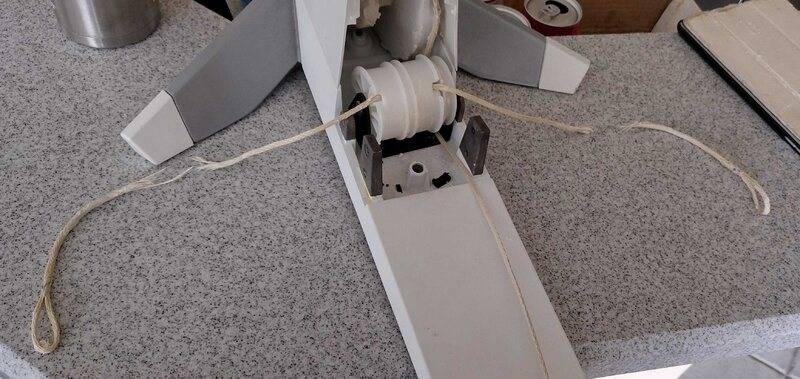

I'm attempting to repair my Ergotron Workfit station. After taking apart, I discovered the problem. A single nylon rope split, releasing the spring's tension. Because it is past the warranty, the manufacturer is recommending I toss the whole assembly and buy a new $650 one. Doesn't seem the sensible thing to do over a $1 rope.
You can see from these photos, there are a total of 3 nylon ropes; one from the spring's base, one through the lower center spindle, and one longer rope just behind and to the right of the lower spindle. I'm sure that one extends up through the wheel next to the spring.
I cannot find any mechanical specs on how these 3 ropes come together and I'm hoping someone here can illustrate so I can reassemble with the new 100lbs, nylon cord.
I just can't imagine how one rope can snap in two places simultaneously. Normally once one section breaks, it relieves all the tension in the remaining cord. There'd be no second break in the same rope.

I think when the first rope broke the spring put tension on the other one and it broke too.
The mechanism reminds me of a garage door spring and pulley setup where the spring counterbalances the door. This may be the case here too.
In the garage door case though usually its the spring that breaks over time and then you hear this explosive sound as it flails around breaking car windows (if there's no cable running through it) and mounting brackets.
For your mechanism it looks like the nylon rope is wrapped around the pulleys and then each end is attached to the spring.

Agreed about lowering the tension. I'm certain that is at least part of the factor when it comes time to reload. I'm just stuck trying to wrap my head around how these ropes interact. The lower rope that broke in two parts, feeds through the center lowest spindle. Then each end of the loops connect to the spindle just behind it.
That still leaves the LONG rope you see extending out the bottom next to the broke ropes - & - the short rope connected to the hook on the spring. Each and every rope ends in a loop which connects to something.
My only guess is that both the short and LONG ropes connect to this lower broken one. That the LONG rope loops over the wheel next to the spring and back down to the base.
Is this LONG rope a reverse tension on the spring somehow?

I don't have a specific answer, but here is a plausible lead-up to the problem.

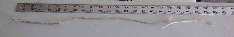

That may be one continuous piece of rope but it looks like it is installed and operates as two ropes (or strands) in parallel.
For the four breaks to happen in pairs there must have been a concentration of wear at those points, likely due to the vertical position of of the work surface. For instance there were probably two preferred table heights in use.
While it is apart, look for and polish any rough spots that may contact the rope.

Yeah. Mostly I'm scratching my head trying to figure out how the ropes load the spring so that the weight of the monitor zeros out. The manufacturer (out of good legal sense) have left that information out.
I think the key to understanding, is going to be how the LONGER rope goes over the wheel at the top of the spring. Where it runs and connects from there.
My experience with wire-ropes in motorcycles has been that they always fail by the area were cyclic bending happens, like next to a wrapping element that frequently rotates in both directions.
In your case, both nylon ropes seem to have been fatigued by the bottom pulley and many up and downs adjustments.
Perhaps a wire-rope surrended by plastic (like used in gym machines) could be a better option than original nylon.This may help you:

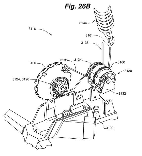

https://patentimages.storage.googleapis.com/3d/f3/0d/946b5923516afd/US8826831.pdf

Okay. This is a big help! Changes my thought on how they come together. I previously thought lines 3135 & 3161 looped onto line 3132. Clearly, not correct.
Now if only I could figure out where 3135 & 3161 actually attach to. 3135 does pass under the spindle (3130). Is it possible that 3161 somehow attaches to the spindle (3130)?

Don’t forget there is a pulley up by where the spring is attached to the frame, I suspect a rope must loop around it too.
That doesn't look like nylon to me, it looks like high modulus polyethylene (HMPE aka UHMWPE), trade names Dyneema, Spectra etc.) You can confirm this by heating with a flame: nylon will melt and shrink back on itself quickly and can be easily moulded when hot, dyneema is different (difficult to describe, you have to experience it really) and tends to just burn.
Also I would guess that HMPE is specified for this application beacuse it has a very low stretch: if you use nylon the table would bounce as you type. HMPE is also much stronger for a given diameter: a breaking strength of 100lb sounds inadequate for this application (the line in the picture looks about 5mm: this would have a breaking strength of about 2 tons).
To overcome the problem with wear you could use line with a braided polyester sheeth (I would not recommend aramid (Kevlar) or wire for this application as it seems to have some low radius bends).

I have a monitor stand by Ergotron and managed to look inside. It is much simpler that the full workstation though.
At the top of the column, there is a pulley with two different diameters.
The rope from the spring goes around the smaller diameter section, thru a slot and around the larger diameter section.
The rope then connects to the monitor mounting itself, the part that 'goes up-and-down.'

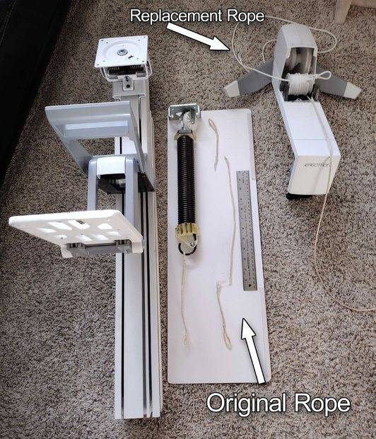

@gary808 I managed to replace all 3 ropes and get mine reassembled, and have put together a youtube video illustrating every step. I hope this is helpful to everyone here!
This is great. Thank you for taking the time and effort.
I don't even own this piece of furniture but I found the explanation very interesting and well explained.
Besides, it's always nice seeing people trying to repair things in these times when the idea of throwing away and buying a new one is more present than ever.

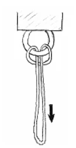

I haven't watched the whole video. A couple of points on your eye splices:
  • Pulling the loop through the rope creates a twist in the Brummel knot. You can undo this by pulling the rope back through the knot as shown in the videos I will link below.
  • Recommendations vary for the length buried inside the core: I have never seen less than 50 times the diameter recommended but more often 60 which is what I aim for. The rope you are using looks like 4mm SK78 Dyneema (is that correct?) which implies a bury of 24cm for each end. For these short loops you haven't got room for that so I would just bury as much as I can.
  • You should taper the ends of the rope before burying them: pull out 6 of the twelve strands starting 6 braids away from the end and cut them as shown in the videos below.
