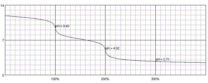

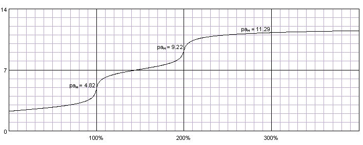

Which of the following, Na3PO4 or C2H4(OH)2 could produce a pH curve with two buffer zones?
I think the answer is Na3PO4 because it can react twice, but the third reaction may not complete. C2H4(OH)2 is ethylene glycol. Is it possoble for it to react with water to produce a pH curve? Any help would be appreciated.

In practice the last two endpoints are difficult to resolve. There is nothing fundamentally wrong in actually TRYING such a titration. A typical lower division (and sometimes upper division) lab exercise is to titrate orthophosphoric acid and make a titration curve of volume of titrant versus pH. ( orthophosphoric acid, H3PO4 )
Ah, there is nothing like being an author of a program that calculates such curves :wink:
This is phosphoric acid tritrated with sodium hydroxide (both 0.01M).
This is phosphate tritrated with hydrochloric acid (both 0.01M).
