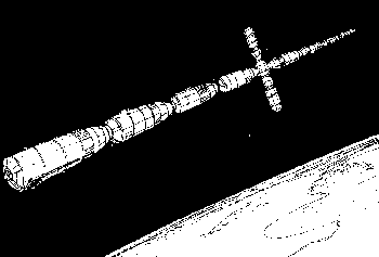

AG can - in principle - be created much more economically than a giant ring. Two modules (eg. 1st stage tanks) linked by cables and spun will work.
Or just one long station.
Still plenty of engineering, but significantly less than a ring.
