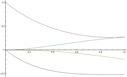

If I plot the solution I can check the correct answer:
Code:
Plot[Evaluate[Table[xi[i, t] /. sol, {i, N}]], {t, 0, 1}]

sol = NDSolve[{Join[diffEq, initialCond]}, X[t], {t, 0, 1}]
And you can plot solutions with:
Code:
Plot[Evaluate[Table[xi[i, t] /. sol, {i, 1, n}]], {t, 0, 1}]
