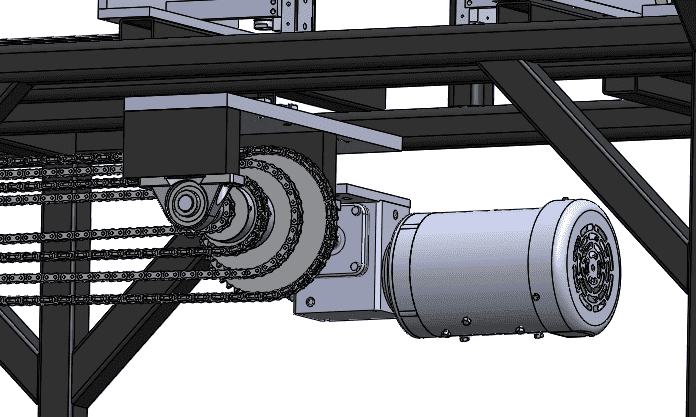

Hello,
New here but thanks in advance for help.
I need help sizing a motor/gearbox for a machine i am working on. known specs are below:
I have a solid shaft driving 4 gears that are all different sizes, the gear with the most weight attached has a pitch diameter of 7.65 in and they are sized evenly so the 4th gear has a ratio of 1:4 from the larger gear. Gears are pressed and have set screws onto the shaft and may potentially get a key way as well.
Its task is to move a weight of 66 pounds horizontally on a linear bearing rail. I don't know friction numbers for this bearing but they are low friction grease-less linear ball bearings. The other 3 gears are pulling/pushing 36 pounds each horizontally on a linear bearing rail. So one gear moves 66 lbs and the other three move 36 lbs each.
They basically move a set of support rails evenly at different distances but run off the same shaft.
shaft coupled to the motor is 1" in diameter and roughly 14" long.
I need to move this weight 160 inches in 4 seconds.
i would like a safety factor of 3 as well.
there are no concentration factors on the shaft as of right now.
for any other information, ask and i should have access to most measurements.

I will attempt to get a couple screen shots of the design. I am moving masses of 66lbs and 36lbs. the larger of the 4 gears is moving a mass of 66lbs. The other gears are moving a mass of 36lbs each. so a total of 174lbs (Roughly) is being moved at once. the HIWIN linear bearing has a coefficient of friction near .004 according to the catalog and mass is moving horizontally.
The motor will start, move the masses into there position and stop controlled via transducer. Then start when prompted to move the mass back to the start position and so on. The motor options are open as that's what I'm trying to determine what will be the best fit for me.
Information on the Chain drive gears are as follows.
Gear 1: Mcmaster-Carr #6236k215
Gear 2: Mcmaster-Carr #6236k187
Gear 3: Mcmaster-Carr #6280k853
Gear 4: Mcmaster-Carr #6280k664
I have not factored in weight of chain into my mass.
I know i have a motor drawn in the model but its for visual aid only at this point.

Your screen shot appears to show that the masses are driven through chain attachments by two different sprockets of different diameters. If so, one mass is moving a different distance than the other mass. Do the above calculation for the mass that moves the farthest, the velocity and acceleration of the other mass is proportional to the drive ratio.
Calculate friction force and peak acceleration force for each mass. From that, and the drive sprocket diameters, calculate torque on the drive shaft. Calculate peak RPM of the drive shaft. Most induction motors run at 1800 or 1500 RPM depending on your electrical power. Now you can calculate drive ratio and motor power.

I am concerned that the gearbox shown in the image might be a worm drive. That might need a slip-clutch, flexible link, or belt at the output, so a sudden stop of the motor or slide does not damage the gearbox.
Since all slides on rails are driven at different speeds, totals for the different rates are separate. To begin I would gather and tabulate the data for each separate slide.
1. No of teeth on the drive sprocket.
2. Pitch of that chain, or pitch diameter of that sprocket.
3. Maximum weight of that chain. (Chains are all different lengths).
4. Maximum weight of that moving slide.
Are you able to construct that 4x4 table once to save others searching through posts and duplicating the effort and questions ?
Baluncore, sorry for the delay in my response. Its been hectic here.
If i understand you correctly this is the information you are requesting...
Gear one:
48 tooth sprocket
24.017 inches per rev of sprocket
Pitch diameter of 7.56"
The weight moves a total of 160 inches
the weight has a total mass (including chain and slide) of 86 pounds roughly
That is only one gear and slide.
There are three other gears, moving three other slides.
I wanted to make sure this is the information needed, and i also thought they would be proportional.
Here is the information on the other three.
Gear Two:
36 tooth sprocket
18.022" inches per rev of sprocket
Pitch diameter of 5.74"
The weight moves a total of 120 inches
the weight has a total mass (including chain and slide) of 48 pounds roughly
Gear 3:
24 tooth sprocket
12.034" inches per rev of sprocket
Pitch diameter of 3.83"
The weight moves a total of 80 inches
the weight has a total mass (including chain and slide) of 44 pounds roughly
Gear 4:
12 tooth sprocket
6.07" inches per rev of sprocket
Pitch diameter of 1.93"
The weight moves a total of 40 inches
the weight has a total mass (including chain and slide) of 40 pounds roughly
If roller chains are all 0.5" link pitch.
Gear, teeth, circum", PD", dist", mass lbs
1, 48, 24.0, 7.64, 160, 86
2, 36, 18.0, 5.73, 120, 48
3, 24, 12.0, 3.82, 80, 44
4, 12, 6.0, 1.91, 40, 40
