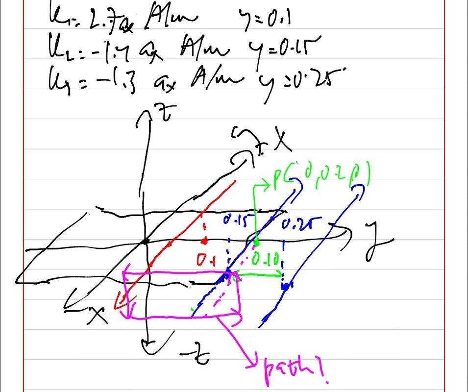

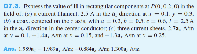

hello everyone, i have a question about magnetic field from infinite current sheet...
the equation will be related with the application of Ampere's Law on current sheet
here is the question, don't mind about point (a) and (b) because i have solved them already...the main problem is the question on point (c) :
so far, what i have done is : H = 2.7*0.1-(1.4*0.15+1.3*0.25) = -0.265 az A/m which is the wrong answer compared to the solution provided from the question...any help is really appreciated, thanks before

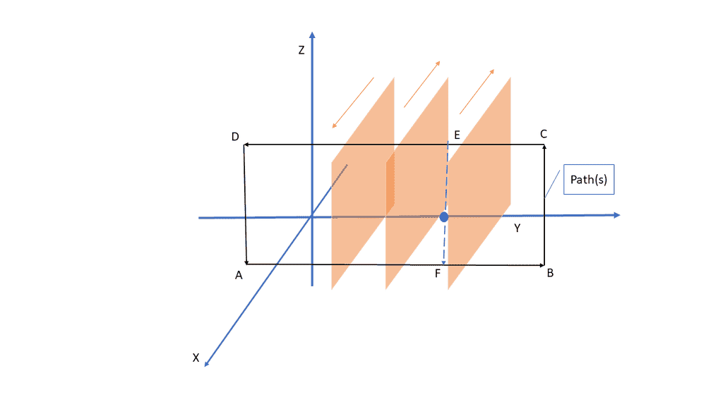

Use Ampere's law ##\oint \vec H d \vec l = I## twice. Use a rectangular path (which have to be in the plane perpendicular to the current direction). The first one would have to include pieces of all three current planes; this would give you the field on both sides of the stack of planes. The second one would have to go through your test point P.

i am sorry, i really don't understand about your clue...i did try to find another example for a whole week after posting that question here... the possible way i could think of is like this :
(2.7-1.4) X ay = 1.3 az A/m but i am not sure if the way i get the answer is right or not...

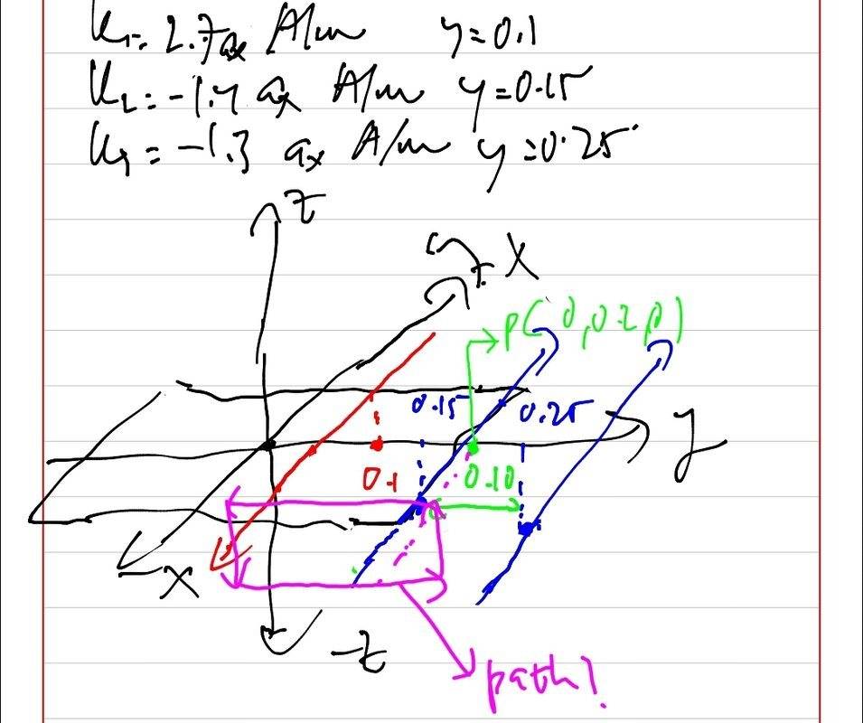

ok, here is the path, P is the green one, and pink line is the path.
about this
i was doing a calculation with cross product, but i am not sure if this is the right way to do, since
H=K X an
so please tell me if i am doing it wrong or not

oops, sorry, I have a symbol missing in Ampere's law, it should be ##\oint \vec H \cdot \vec l = I##, i.e. dot product, not cross product and I is the total current enclosed by the loop with the direction given by the right hand rule.
Now, you notice that you can move vertical vectors left or right (i.e. changing the length of the horizontal vectors, portions of the path) and as long as they don't cross current planes, the enclosed current remains the same. This tells you ##H_y = 0##. Similarily, the loop can be moved up or down and, since the current density is constant, the ##H_z = const##
Now, consider the two loops, ABCD and FBCE and you should get the correct answer.

based on the diagram, the result is like this :
##H_z * l = K * l##
##H_z =##(loop ABCD)+(loop FBCE) = (2.7-1.4-1.3) + (-1.3) = -1.3 ##a_z## A/m
is that result correct?
