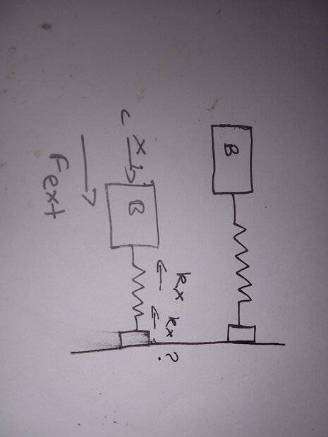

A block (B) is attached to two unstretched springs S1 and S2 with spring constants k and 4k, respectively (see fig 1). The other ends are are attached to identical supports M1 and M2 not attached to the walls. The spring and supports have negligible mass. There is no friction anywhere. The block B is displaced towards wall 1 by a small distance x (fig 1) and released. The block returns and moves a max distance y towards wall 2. Displacements x and y are measured with respect to equilibrium position of the block B. The ratio y/x is:
None
I haven't tried anything yet as im stuck at interpreting what the question asks itself.
Firstly the only force acting on M1 support is the spring force (kx) why did it not move?
Secondly is the reason of it not moving the fact that is also pulling the string with the same force (kx) so it is returning to its position against the wall?
I might have more questions as these get cleared sorry for the inconvenience :(
Posting the picture might be useful :rolleyes:
And posting a best effort is mandatory in PF :wink:

I edited it just a minute later sorry the pic is up and running
Where's it going to move? Through the wall?
The spring force acts forward I.e in the direction opposite to the applied force right? So wouldn't the spring be pulling on the support M1 instead of pushing it as you say.
Spring S1 is compressed.
M1 is being pushed into the wall, not pulled away from it.

Yes but the point of application of force is the point connecting the head of the spring and the block B, the head of the spring gets compressed and produces a spring force equal to the extension times , in the opposite direction. Is it not the latter force which acts on the support M1?
Yes, but that force pushes M1 into the wall. A compressed spring is not going to pull M1 away from the wall.
If you pulled B in the opposite direction (to the left) that would extend the spring and pull M1 away from the wall.

I dont think I explained really well this is what I meant, I just dont get how the external force is transmitted through the spring, I thought the reaction force or the spring force is responsible for transmitting the external force to the block.
I dont think I explained really well this is what I meant, I just dont get how the external force is transmitted through the spring, I thought the reaction force or the spring force is responsible for transmitting the external force to the block.View attachment 342307
That's not how a spring works.

I think ive made some progress with this and the question. So what ive gathered from spring mechanism is that S1 the string being compressed is also applying a force pushing the support into the wall and at the same time there's a restoring force which is equal to the external force which is being applied on the block . This i concluded because the spring S2 has not deformed which means there is a net zero force on it.
When the external force is removed, i.e when it is released from rest, there's a net acceleration in the direction of wall 2 because of the restoring force which cause block B to get back to its equilibirum position and since it was accelerating, it still has velocity in the direction of wall 2 and it moves compressing spring S2 till it reaches v=0 making it the maximum displacement of the blcok where there's momentary rest.

That's a reasonable summary. Note that the initial diagram is misleading as it shows both springs compressed. However, the problem statement implies that only S1 is compressed.

In the top figure (I) we have to assume that both springs are at their equilibrium lengths as stated. The bottom figure (II) shows the mass displaced by ##x## to the right and the end of spring S2 also displaced to the right by ##x##. Therefore, in the bottom figure S2 is at its equilibrium length. It looks like the springs are just drawn inconsistently from (I) to (II).
