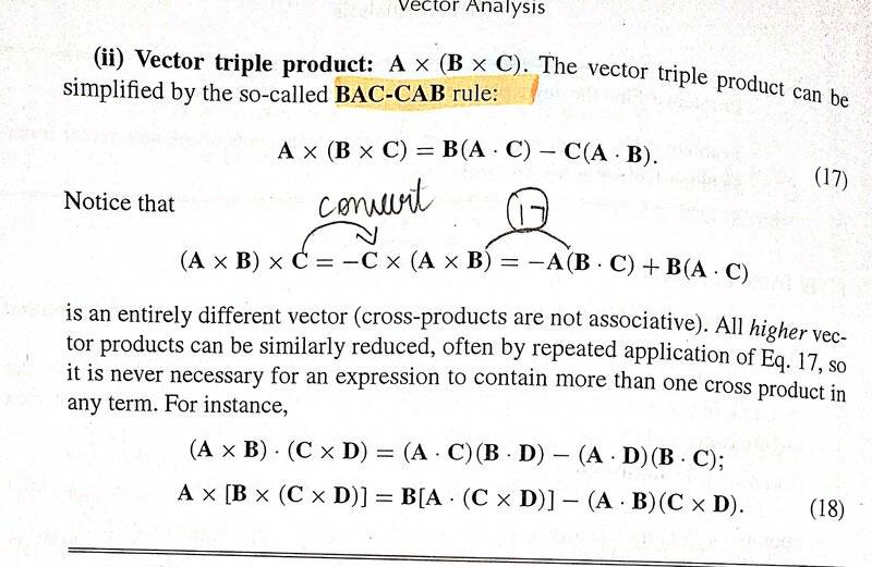

Need help with Vector Triple Product mentioned in Griffiths Introduction to Electrodynamics

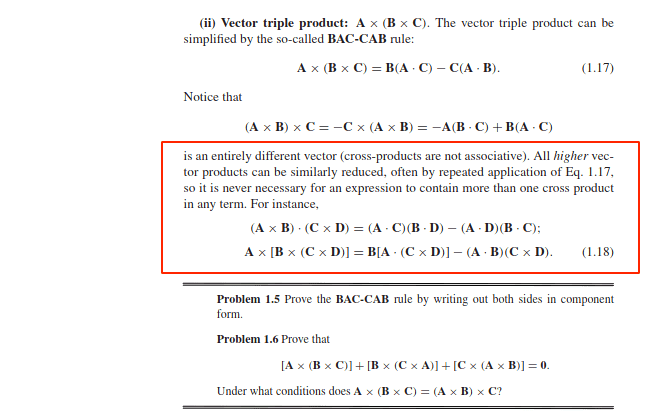

I don't understand anything about how 1.18 came to be (Red Rectangle), any help would be greatly appreciated!
The second equation in (1.18) follows from (1.17) by first applying it to [itex]\mathbf{A} \times (\mathbf{B} \times \mathbf{E})[/itex] and then setting [itex]\mathbf{E} = \mathbf{C} \times \mathbf{D}[/itex].
For the first, you can use the cyclic nature of the scalar triple product [tex]A \cdot (B \times C) = B \cdot (C \times A) = C \cdot(A \times B)[/tex] to get [tex] (A \times B)\cdot (C \times D) = (B \times (C \times D))\cdot A[/tex] and then apply (1.17).

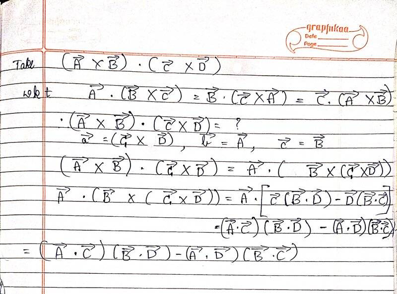

applied 1.17, arrived at the line before 1.18, can't get to 1.18, can you please solve the last step?
edit: You are not supposed to arrive at 1.18 from the line before it. They are separate examples. This problem seriously made me re-evaluate my life choices. Did the author think the reader would be able to tell, yeah, I see no discontinuity here. I mean, i feel like he should have included more steps.
got it [Mathforums Link]! Thank you @pasmith
The semi-colon (;) at the end of the first equality indicates that the two equalities are not related.

I think Griffiths should have given each equation its own number. That might have usefullly emphasized the lack of connection. Otherwise Yep.
Slimy0233 said:
TL;DR Summary: Need help with Vector Triple Product mentioned in Griffiths Introduction to Electrodynamics
View attachment 327595View attachment 327596
