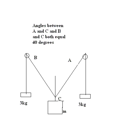

Also, I don't really get this one either. I'll attach a (very) rough diagram that I've copied from the sheet.
1. Calculate:
(a) the tension in the strings A and B (trivial),
(b) the tension in the string C,
(c) the mass m.
For part c I know that W = mg and that g = 9.81, but how do I work out W?
Thanks.
Cathy

have you drawen the free body with forces?
No, because I really don't get how to draw the diagram.
ok it says suspended so? hanging from right? You have one mass held up by 2 ropes. those to ropes are not hung straight up, but at angles to the vertical axis. so the ropes form some what of a "V." draw a straight line through the middle of those 2 ropes (through the "v"). where the ropes com together at the bottom with your straight line "y axis" in the middle create an angle of 30 deg. to one side and 80 deg. to the other side. It would look very similar to the drawing you posted except get rid of the 2 additional masses and ropes on the sides. Does this help?
Thanks so much! That has really helped! :smile:
Cathy
So for T30 I got the vertical componet to be 34.6 N. Is this correct? Also, is the vertical component the same for T80?
Cathy
what is the work you have done? What resultant equations do you have?
