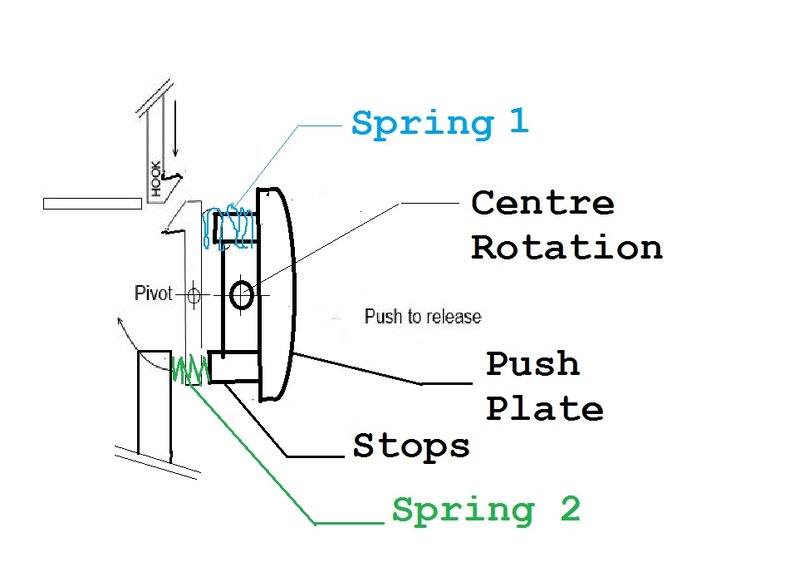

Not sure how much freedom you have to change things but here are two ideas...May need to add a spring to the first.
PS: The second suggestion assumes the latch is part of an injection moulded lid or similar. It's a bit tricky to get the material to flex just right. Ideally you would make the mould so the flex point is a bit too thin (latch likely to be too flexible) then inject some samples and test. That way you can remove metal from the mould to make it stiffer. If you do it the other way around you have to add metal to the mould and that's a bit more expensive.

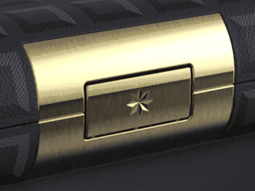

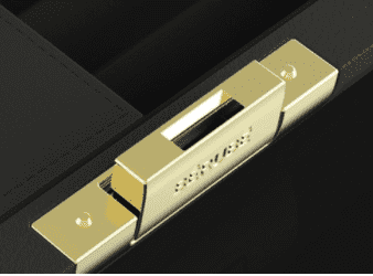

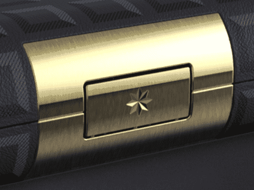

Hi guys, sorry for the late response. Let me show you an outside view of the latch so you can understand your constraints. The original sketch is a cross section of this mechanism. The 'hook' is molded into the upper subframe. The latch molded into the button. This needs to look good closed AND opened.

I kind of like @CWatters design to the left.
With slight modification
The push plate and latch are two separate pieces, that rotate either about the same centre or different centre
Push plate can move latch clock wise to unlatch, and counterclockwise to latch.
Push top of push plate to close if needed and the latch and hook due not connect on their own.
Push bottom of push plate release latch and hook to open.
Spring #2 holds push plate in normal position.
Spring #1 hold latch in close position.
Giving this as another option of many to contemplate.
If this is a piece of luggage, it might be a good idea to recess the button and/or have an additional interlock on the latch. As it is shown, there is a good chance the button will be activated when being tossed around by baggage handlers.
