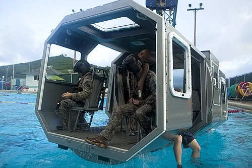

I’ve recently read about training for worst-case scenarios and as you mention some of them is simply considered too far out to merit training. Here’s a picture of soldiers training for an underwater helicopter crash:
Two uniformed soldiers in helmets and flight gear sit inside a grey octagonal underwater escape trainer floating in a swimming pool, with a third person's legs visible below the open side.
(Courtesy of Wikipedia.)

I think that this in many places is considered required training (i.e. it is considered a likely accident type) for professions regularly being transported off- or near-shore by helo. For instance, a GP doctor in my family had to take this training before working as GP in northern Norway for a few month.
