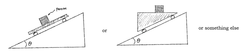

A person with a mass of M is on top of a platform with wheels, they fall in solidarity through the inclined plane of angle theta. There is no friction between the platform and the inclined plane(ideal wheels), but there is friction between the person and the platform.
Find the friction force the platform applies to the person
none
im having trouble writing the newton ecuations, i do not understand how the friction force is applied to the person. I wrote this:
The coordinates that i choose are X in the direction of the movement, and Y perpendicular to X
Forces applied to the person are the Normal force NA (vertical and up), the persons weight PA (vertical and down)
forces applied to the platform : Normal Force NB (perpendicular to the inclined plane) the platforms weight PB(vertical and down)
The thing is the excersise does not have any data of how much the weights are or the angle theta or the coeficients, and i do not understand if the friction force is horizontal on the person or it is in the opposite direction of the inclined plane

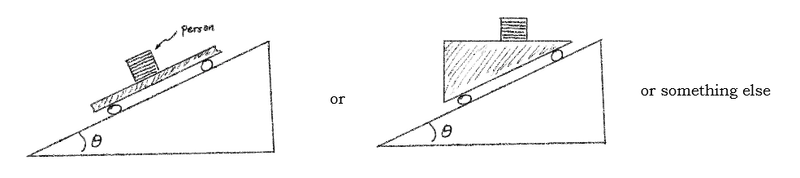

TSny said:
The teacher provided a drawing that looks like the second here..
My doubt is about the friction force, is it horizontal or diagonal? im having trouble to understand why would it be horizontal or why would it be diagonal. Since the movement is to roll over the inclined plane, I thought it was in the opposite direction of the movement(diagonal) but i am not getting the same result as the teacher which is mg.sin(o).cos(o) (o being theta)
See post #5. When an object is in contact with a flat surface, the friction force that the surface exerts on the object is parallel to the surface. The normal force that the surface exerts on the object is perpendicular to the surface. Apply this to the person in your problem.
Construct a free-body diagram for the person.
There are two forces exerted on the person, one is the vector weight ##\mathbf W## and the other the vector contact force ##\mathbf F_c##. The vector sum of these is the net force and is equal to the net force, which is equal to the mass of the person times the vector acceleration, $$\mathbf F_{\text{net}}=\mathbf W+\mathbf F_c=M\mathbf a\implies \mathbf F_c=M\mathbf a-\mathbf W. $$1. Can you find the vector acceleration of a mass sliding down a frictionless incline? If so, you can find ##M\mathbf a.##
2. Can you find the vector weight of a person of mass ##M##? If so, you can find ##\mathbf W.##
3. Can you subtract the two vectors as indicated by the equation above? If so, you can find ##\mathbf F_c.##
4. Can you find the component of ##\mathbf F_c## parallel to the surface? If so, you have answered the question.
Although drawing a free body diagram is the usual approach, this particular problem can be treated as a simple vector addition problem because the acceleration can be determined independently in step 1. Also note that the method can be used to find the direction of friction in general when the plane of the platform is at any direction relative to the horizontal.
