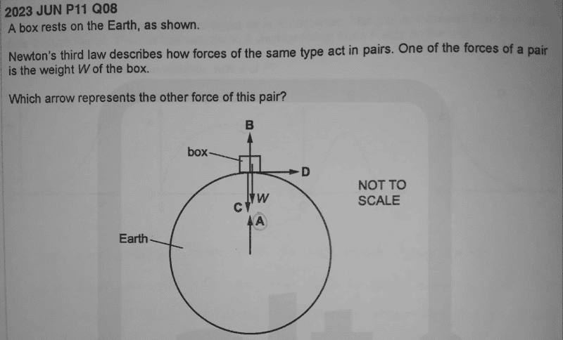

pic below
newtons 3rd law...
my answer was B
because wont it B be as its the normal reaction force? due to the newtons 3rd law??
correct answer is A...
No, W and B are not a 3rd law pair. Two forces being a third law pair means that they are forces between two objects - one the force from the first object on the second and the other the force from the second on the first. W is the force of gravity on the box exerted by the Earth. B is the contact force from the Earth's surface exerted on the box.

B = the force exerted by the surface of the Earth on the box.
W = the force exerted by the entire Earth on the box.
If there were a hole at B, i.e. no surface, the box will fall in and get closer to the center of the Earth because W is still acting on the box.

My usual example is to imagine pushing with your hand on top of the box. The weight and the normal force from the Earth on the box are no longer of the same magnitude so they cannot possibly be a 3rd law pair.

Also, this is simply wrong. Both W and B are forces from the Earth on the box (with the further subdivision into Earth surface/entire Earth given above). W is the gravitational force of the Earth on the box, not the gravitational force of the box on the Earth.

Others have explained why W and B are not a second law pair. There is also clue in the question: "forces of the same type". The type distinction being made here is gravitational forces versus contact forces.

No. W and B act on the same object so they can't be a third-law pair.
W is the gravitational force exerted on the box by Earth.
A is the gravitational force exerted on Earth by the box.
