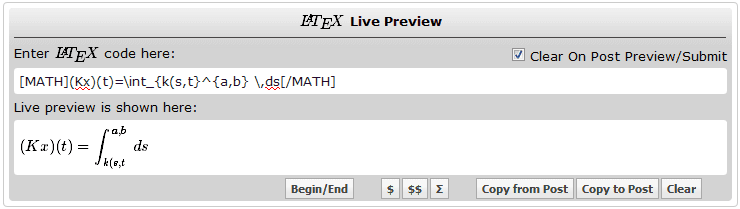

Another $\LaTeX$ tip:
To practice, you can enter your expression into our $\LaTeX$ Live Preview to see how it is going to render in your post once submitted. Click one of the tags buttons (the dollar signs or the $\Sigma$ button), then put your code in between them, and you will instantly see a preview:
Once you are satisfied, you can then copy the code to your post at the current cursor location by clicking the "Copy to Post" button. If you are just practicing, you can enter other expressions and then once done, just abandon the post. :D
