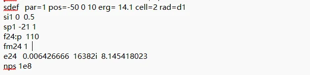

I am using MCNP with a DT neutron source and I am interested in prompt gamma measurements. My detector is modeled as a simplified volume, and I am currently using an F4:P tally with energy bins to obtain the photon spectrum.
Since the F4 tally gives photon flux per source particle (ph/cm²/source), I would like to ask:
What is the correct way to convert or normalize an F4 photon flux tally to counts, so that it can be meaningfully compared with experimental spectra or reported as detector count

It might be possible to do that with an F4 and a cross section multiplier but F8:p,e is a better way on the cell of the crystal, and the tally result is in total counts.

HeHello Thanks for your help. I have no of particle per second . Shall i multiply it with count getting from F4?
If you have no way of getting the number of particles started per second, then you cannot normalize to that basis. You can only report the results in terms of per-particle-started. You can still give a spectrum, but only normalized on the basis of per-particle-started.
You can still do some useful calculations. If the real system reports a spectrum, you can scale your spectrum to try to match it. So if you have energy bins for your spectrum that match the energy bins reported for the actual system, you can try to find a number that will multiply your spectrum to make it similar. Like so:
Real system reports (as a pretend example) 1 2 1 2 1 2 in the energy bins. (This is absolutely not meant to be realistic.)
And you calculate 0.1 0.2 0.1 0.2 0.1 0.2 then obviously you want to multiply your results by 10 to make it compare to the real system.
This is sometimes the best you can do.
I read 'I have no of particle per second' in that reply to mean 'Yes, I have the number of particles per second'.
But what I believe is needed is the number of counts in each bin, not the flux at each energy. This can be done with an F8 tally. It can also be done with an F4 tally and a cross section multiplier.
