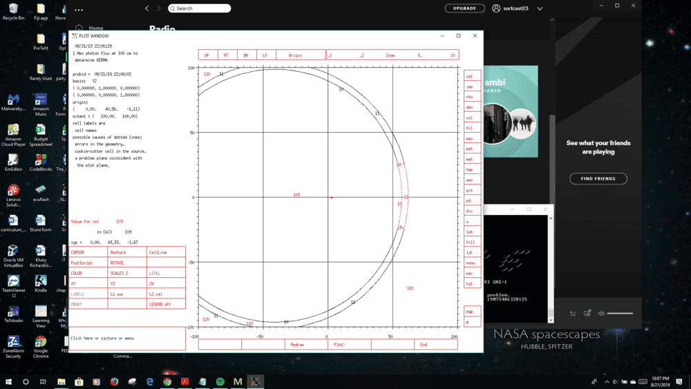

I am trying yo find the flux in a cell which is bounded by two concentric spheres and a cone. When I run the code I get a warning that no cross section tables are called for in this problem and a tally result of zero. The way I defined the surfaces and cells is below if anyone sees where I have made a mistake please let me know. I have also attached the code, output and a screen shot of the geometry plot.
1 Mev photon flux at 100 cm to determine KERMA
C Simulate an isotropic point source of 1 MeV photons
C Cell Cards
109 0 -10 IMP:P,e=1
110 0 -11 10 IMP:P,e= 1 $ cell volume inbetween 97.5 and 102.5 shells
120 0 -12 11 IMP:P,e=0 $ Graveyard
130 0 -11 -13 IMP:p,e=1 $ creates a volume bounded by the conical surface as well as concentric spheres
C Surface Cards
10 SO 97.5 $ Creates a 97.5 cm sphere
11 SO 102.5 $ Creates a 102.5 cm sphere
12 SO 200 $ creates graveyard
13 KY 0 0.0625 1 $ creates a conical surfface
C Data Cards
MODE p e $photon and electron transport
C tally card
*F4:p 130

I want to add that I get a result when I *F4 tally on cells 109 and 110.
All regions must be covered exactly once. You have some cells overlapping. I fixed it one possible way. The old cells are commented out with the new cells shown right after.
You can detect these kinds of things with the plotter if you plot through a surface that involves the offending surfaces. In this case, you need to plot through a surface that intersects the cone. You will see the tell-tale red dotted line. Whenever you have something whacky happening in MCNP, first look for the red dotted line. Change the plot between xy, xz, yz. Change the origin to several places within your model.
You do not have any materials defined.
Each cell should have a material number as the second number, but all of your cells are void (material 0).
No materials, no cross sections.

Going back to your original problem, I would focus on the geometry errors pointed out by @DEvens.
First, all of the geometry should be covered by non-overlapping cells. You should also pay attention to the boundary conditions.
Second, you have defined a region with zero importance (called the "graveyard"), but your tally is outside that region. Once the particle hits a region of zero importance, the code will quit tracking the particle and you will never get to the tally region. Define a non-void region all the way to the tally region, then put a voided region beyond the tally region.
