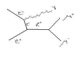

Timo: Ok, but if the beam have 65.129 GeV, the Z boson will be emited with some kinetic energy. But what will be emitted to compensate for the momentum violation? (since we must have overall momentum conservation here?)
V-50: So what reaction can give away two muons and a hadronic signal in an ee-bar collider @ 65GeV beam energy? :S
malawi_glenn said:
What reaction can give away two muons and a hadronic signal in an ee-bar collider @ 65GeV beam energy? :S
e+e- goes to Z + something else. The most likely "something else" is a photon going down the beampipe. In fact, you can see it in the picture - it's the green thing on the right. It says 32.8 GeV of energy was detected in the forward calorimeter: 65*2 - 33 = 97 GeV, pretty close to 91 GeV.
Well yes that is of course possble, so the remaining 6GeV could be kinetic energy of the Z.
So the feynman - diag would be: https://www.physicsforums.com/attachment.php?attachmentid=13824&stc=1&d=1209838584

Yes, a diagram like that.
cool! :biggrin:
Thanx a lot Van-50 and Timo! See you around, and enjoy PF and life
