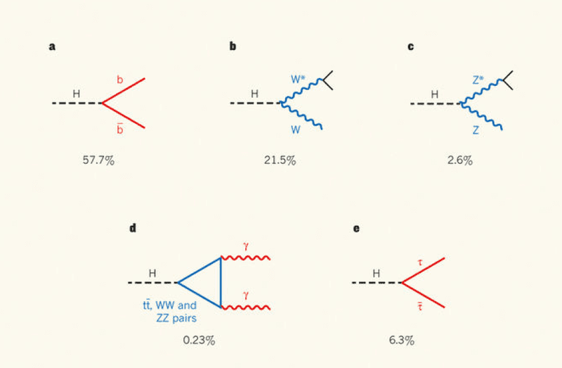

My line of reasoning is this: I first had a look at the decays where the Higgs particle couples directly (i.e. without intermediate particles) to the products; those are ##H^0 \to b \bar b, \ H^0 \to \tau \bar \tau## and ##H^0 \to c \bar c \ ## (##H^0 \to t \bar t## is of course not allowed due to conservation of energy; the top quark is about ##t \approx 172 \ GeV## while ##H^0 \approx 125 \ GeV##). Given that the coupling constant is ##m/v##, where the vacuum expectation value is given by ##v \approx 246 \ GeV##, it makes sense to think that the more massive the particle is the stronger it couples to the Higgs particle. Indeed, for those three ratios that argument seems to hold. Do you think it is OK?
Here comes the fun.

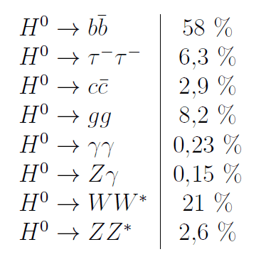

Once intermediate particles come into play I do not really understand why some channels have greater BRs than others. Next, let us look at the "massless" channels ##H^0 \to \gamma \gamma, \ H^0 \to gg##. I studied the golden channel ##H^0 \to \gamma \gamma## (Mandl & Shaw, page 446)
OK so W boson and quarks (only the top quark couples significantly to ##H^0## though) are the intermediators.

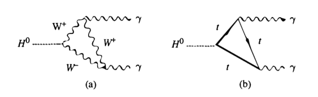

I struggle to find information in the literature regarding the decay channel ##H^0 \to gg##. I looked up Higgs decay to gluon in Google Scholar and checked the first five but found no (modern i.e. not in terms of ) FD. One could guess and say "well, the gluon is massless as well so we could expect to have the exact same diagrams that for ##H^0 \to \gamma \gamma##" (this is actually the same guess a PF user made back in 2014). I do not think this is right, as the BRs differ quite significantly so I expect the associated FDs to differ as well. Hence
What are the FDs associated to ##H^0 \to gg## and why does its BR differ that significantly with ##H^0 \to \gamma \gamma## (despite both products being massless)?
Regarding FDs, I have the same issue with the channel ##H^0 \to Z \gamma##: I do not find them in the literature.

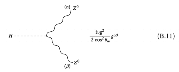

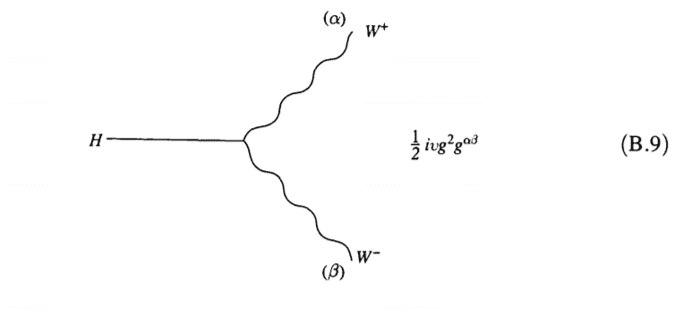

Finally, let me comment on the last two channels: ##H^0 \to W W^*## and ##H^0 \to Z Z^*##. I have studied they have essentially the same FD (b and c below)
My argument to explain their difference in BRs is based on their coupling constants: we know that the Higgs particle couples to W and Z bosons as follows
We also know that ##M_W^2 = \frac{g^2v^2}{4}## and ##M_Z^2 = \frac{g^2v^2}{4 \cos \theta_W}## so we deduce that the ##HWW## coupling goes as ##M^2_W/v## whereas the ##HZZ## coupling goes as ##M^2_Z/v##. Hence this reasoning leads to think that we should expect a greater BR for Z.

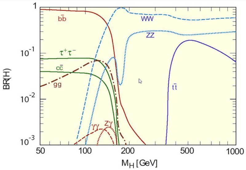

Last comment: in the plot we observe a sudden minimum in ZZ... why?

1) H to gg
-FD ?
Same with gg to H production. Gluon radiations through quark triangle.
-Why BR(H to gamma gamma) << BR(H to gg)?
There is another factor, the coupling constant.
You can compare alpha_s (~ 0.1) and alpha_em (~1/137) to understand difference between two BRs.
2) FD of H to Zgamma
It is same with H to gamma gamma. Replace one gamma to Z.
3) BR(H to WW) vs BR(H to ZZ*)
H to W-W+ channel has factor of two bigger BR compared to ZZ since W- and W+ are not identical particles.
(JHEP03(2018)110)
4) Sudden minimum of BR(H to ZZ*)
If mH < 2mW, there is suppression coming from virtuality of W* and Z*.
If 2mW < mH < 2mZ, H to WW channel gets enhancement from on-shell effect.
Because of this enhancement, BR(H to ZZ) shows sudden minimum.
After mH > 2mZ, BR(H to ZZ) and BR(H to WW) show almost flat values until mH = 2mtop.

It's more instructive to look at the partial widths instead of branching fractions. Branching fractions depend on all other decay modes, partial widths do not.
Using the WW bump as an example: There is nothing special happening to ZZ there. It's just the WW partial width becoming so much larger that it pushes down all other branching fractions - not just ZZ. ZZ would become "competitive" again at masses where the Higgs can decay to two on-shell Z.
