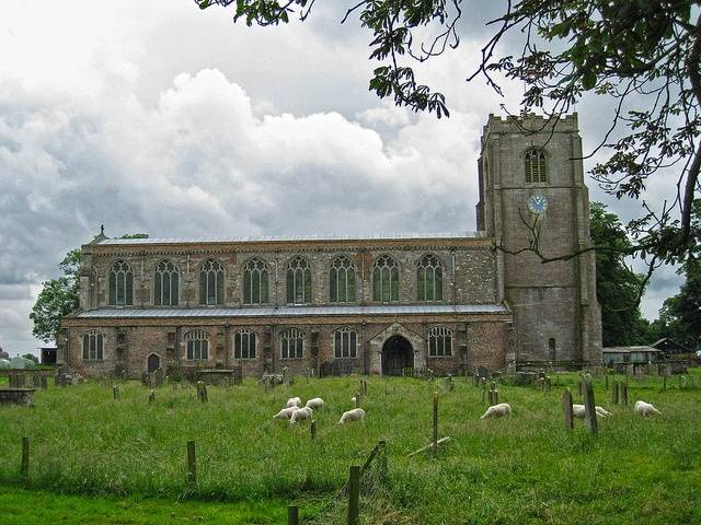

And stealing a sheep would get you hung. Wool was big business. Many of the churches in Eastern England were "buiit on wool" - i.e. from the profits from the land they owned. This one is typical (with sheep still being used to mow the grass in the churchyard) - when it was built the village population would have probably been only a couple of hundred people, and a lot more than 200 sheep.
There wouldn't have been "sacks full" of wool left on the shearing floor in those days - it was worth too much!
