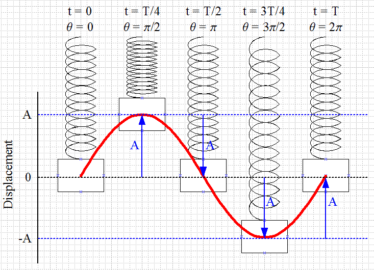

The author may have been thinking in terms of the motion of a mass in a mass-spring system. During one cycle the total distance (path length) traveled by the mass is then 4 times the amplitude.

From "plus 1 amplitude" to "minus 1 amplitude" and back, in total 2*2=4 times the amplitude as motion.

Draw and follow the displacement progress of one cycle:

Thanks people! I just realized it meant the distance that the spring has moved in terms of amplitude instead of how many amplitudes it has reached.
