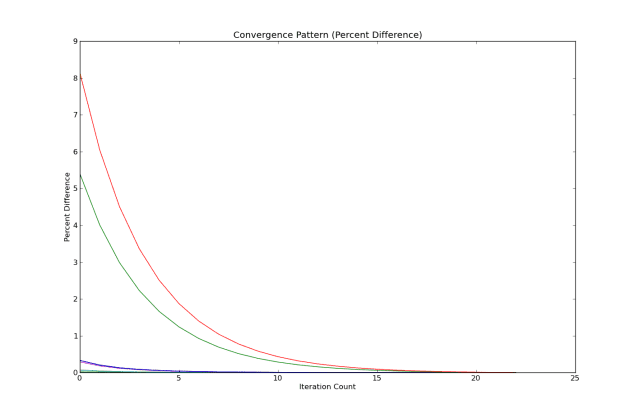

Here's what the changing values look like as a function of iteration count. This plot used the following parameters:
Damping: 75%
Precision = 0.001 (overall sum-of-squares error is less than 0.001).
Delta Percent Load: 1%
With 0.01, it needs 18 iterations and 0.1 requires 14 iterations. For 100, it needs 2 iterations, but the error is atrocious. Also, my code has a numerical Jacobian estimator, so it's dynamically estimating the Jacobian for me. No typo's here.
Looks pretty quadratic to me. I could change it so that it looks for percent difference at each variable to be less than 0.001 (or whatever other precision I wanted), but even then I am looking at 15 iterations.
It looks linear to me. The fractional reduction in the percentage difference looks about constant for each iteration.
For quadratic convergence, you would get about twice as many significant figures correct at each iteration, so the percentage differences on successive iteration would be more like 0.1, 0.01, 0.0001, 0.00000001, etc, (i.e. 10%, 1%, 0.01%, 000001%, etc)
Does "damping 75%" mean you calcualate what the change in the solution should be using Newton's method and then scale it down by a factor of 0.75, or something simlar?
Try setting the damping so Newtons method just does whatever it wants to do, either right from the start, or after a few iterations (say 2 or 3) when it has got into the right ballpark.
Ah, okay. I misunderstood that relationship. My apologies. For what it's worth, here are the 'symbolic' jacobian and the 'numeric' Jacobian. The symbolic solution is the hard-coded equations, hand derived while the numeric solution is generated by calculating a numerical approximate of the Jacobian.

I've been plugging away at my code and have devised a method to dynamically adjust the Jacobian to ensure (or at least, to try its best to ensure) that the solution converges. Ironically, out of this new solution, came quadratic convergence (I think).
Most of the solutions converge now within a few iterations. Here's another example of a well behaved solution. What do you all think?
[PLAIN]http://img39.imageshack.us/img39/3931/25937752.png[/center]​
