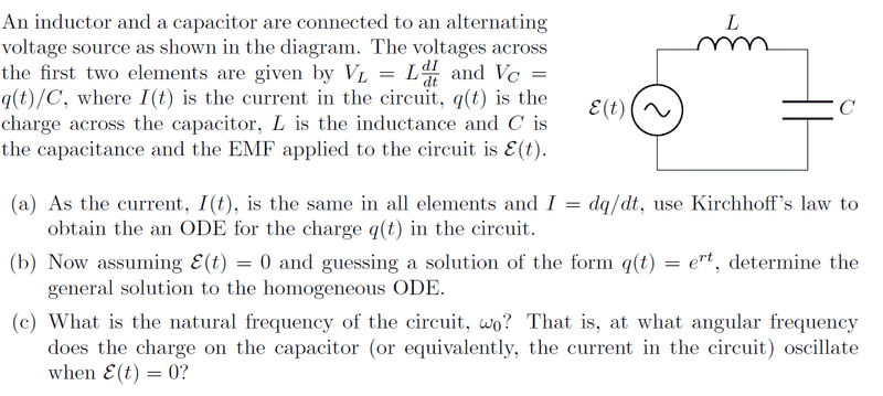

ODE of an electric circuit consisting of EMF source, inductor and capacitor
12 replies · 4K views
songoku
2,521
395
Please see below
Kirchhoff Voltage Law
Integration
(a)
$$\varepsilon (t)=V_L+V_C$$
$$\varepsilon (t)=L\frac{dI}{dt}+\frac{q(t)}{C}$$
$$\varepsilon (t)=L\frac{d^2 q}{dt}+\frac{q(t)}{C}$$
(b) taking ##q(t)=e^{rt}##,
$$0=L\frac{d^2 q}{dt}+\frac{q(t)}{C}$$
$$0=L.r^2 e^{rt}+\frac{e^{rt}}{C}$$
$$0=L.r^2+\frac{1}{C}$$
$$r^2=-\frac{1}{LC}$$
Is it possible for the value of ##r## to be complex number? Thanks
Yes. It just means the circuit is oscillatory. Since there is no resistance it is also not dissipative and therefore has no real part.
Ok, so ##r=\pm i\sqrt{\frac{1}{LC}}## and the general solution will be ##q(t)=a_1 e^{i\sqrt{\frac{1}{LC}}t}+a_2 e^{-i\sqrt{\frac{1}{LC}}t}## where ##a_1## and ##a_2## are constant.
Is this correct?
(c) I don't know to how relate ##\omega_o## to the equation in part (a). Is there any part of the equation actually contains ##\omega_o##?
Thanks

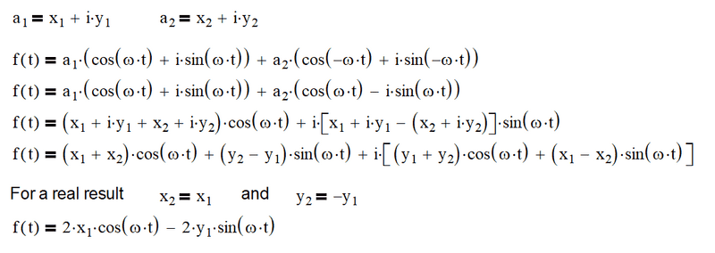

Yes it is correct. Appropriately assigning the constants will result in a real solution. You can also rewrite in terms of sines and cosines. The natural frequency should be evident from this.
songoku said:

## q(t)=a_1 e^{i\sqrt{\frac{1}{LC}}t}+a_2 e^{-i\sqrt{\frac{1}{LC}}t} ## can be evaluated with Euler's formula ## e^{i \omega t}=cos(\omega t)+i sin(\omega t) ##. The natural frequency is then just the frequency that these sinusoids oscillate (repeat) at, ## \omega ## in this case.
In the original equations ## \omega ## is contained within the values ##L## and ##C##. Ask if you want to see how, or better, do it yourself.
Also as @Orodruin said, the values of ##a_1## and ##a_2## will be chosen so that the imaginary term is zero, since the charge on the capacitor has to be a real number.

Only if you impose both constants to be real. The general solution has complex coefficients and so a real solution requires ##a_2 = a_1^*##, which makes the full solution take the form ##z+z^* = 2{\rm Re}(z)## where ##z = a_1 e^{i\omega t}##. This is obviously real.

@Orodruin is correct, of course, the requirement for a real result is the complex conjugate, as shown below. This problem didn't specify the initial conditions of the circuit, which is fine, it's not required for the questions they asked. But in general, you will have to solve for ##a_1## and ##a_2## to match the initial conditions, which might result in complex values. These would be the initial charge on the capacitor, ##q(0)##, and the initial current in the inductor (##\left. \frac{dq}{dt} \right|_{t=0}##).

Ah I see, they should be conjugate.
