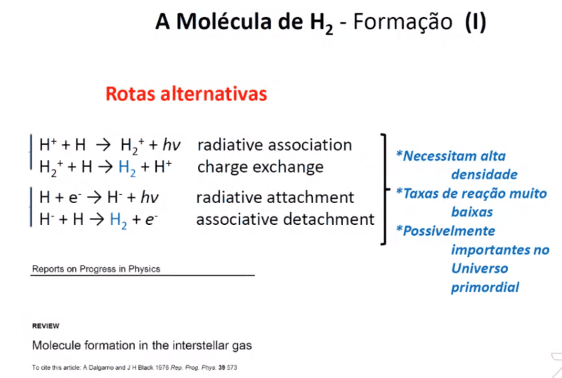

There seems to exist two alternative routes to the formation of ##H_2##, as shown below (slide of prof. Montenegro)

No doubt, but there are different routes to this formation. I posted a figure where two of these routes are shown (#8). I am addressing one specific route. Two atoms of ##H## colliding in vaccum (rarefied media)

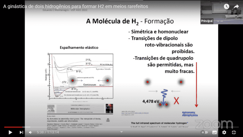

What professor Montenegro says / states in short is:
a) ##H_2## is the most abundant molecule in the universe.
b) most people believe two atoms of hydrogen when colliding may form ##H_2##.
c) two atoms of hydrogen colliding are basically an elastic collision.
d) symmetry of the states 1s in these two ##H## atoms are a fundamental factor in forbiding production of ##H_2## from the collision of ##H## atoms in vaccum.
e) he points that a third physical system is needed for the above process to occur.

The aspect of symmetry is not fully explained in his webinar. He seems to suggest that it prevents dipole transitions. The next alternative, he says, would be the quadrupole transitions, but he said these processes demand long time intervals, compared to the typical values of the duration of this collision.

1) Yes.
2) Yes, any (respectable :smile: ) molecular physicist knows this.
3) Yes.
4) For two atoms in the same electronic state, the transition matrix element for a dipole transition boils down to something proportional to
\propto \int \psi^* \hat{d}_\mathrm{N} \psi \, \mathrm{d}\tau_\mathrm{N}
where ##\psi## is the nuclear wave function, ##\hat{d}_\mathrm{N}## the dipole moment operator, and ##\tau_\mathrm{N}## the nuclear degrees of freedom (this is in the Born-Oppenheimer approximation, and the electronic degrees of freedom have already been integrated over).
For a homonuclear diatomic molecule, there can be no dipole moment by symmetry (for the two atoms initially in the same electronic state), so ##\hat{d}_\mathrm{N} = 0## and there is no dipole transition.
As @Vanadium 50 pointed out, M1 magnetic dipole transitions are dominant in this case. So while two colliding identical atoms can temporarily form a diatomic molecule, M1 transitions are slow with respect to the timescale of dissociation, so the two atoms just fly apart.
The only way to form a stable molecule is to have a 3-body collision, with the 3rd body carrying away the extra energy. The rate at which this happens depends on density and temperature.
