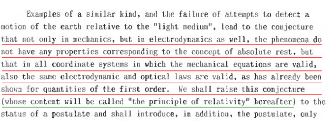

  • #52
A.T. said:
I copy and paste for you from Einstein's 1905 paper. The red and green underlinings are mine.
  • #53
A.T. said:
But P1 doesn't list the specific laws that are true. It just says that whatever laws we use, they should take the same form in all inertial frames. That by itself, without assuming specific laws, doesn't imply a certain transformation. It's only P2 that rules out the Galilei transformation.
Not correct. The first postulate accepts Maxwell's equations along with the laws of mechanics as valid in all inertial frames of reference. Einstein was in effect "raising" Galileo's relativity principle to include electrodynamics too, in opposition to what most physicists at that time. They were happy to have the relativity principle valid for mechanics, and not valid for electrodynamics.

  • #55
If P2 is needed depends on, if you formulate P1 to also inherit Maxwells theory. See also:
Einstein (also 1905 - §2) said:
The following considerations are based on the Principle of Relativity and on the Principle of Constancy of the velocity of light, both of which we define in the following way.
1. The laws according to which the states of physical systems alter are independent of the choice, to which of two co-ordinate systems (having a uniform translatory motion relative to each other) these state changes are related.
2. Every ray of light moves in the "stationary" co-ordinate system with the definite velocity V, the velocity being independent of the condition, whether this ray of light is emitted by a body at rest or in motion.
Source
