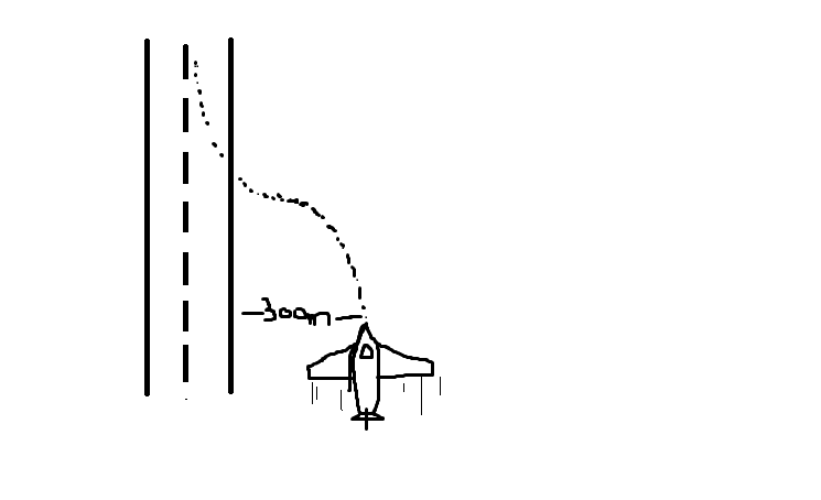

A pilot is flying his personal jet at 180m/s, approaching the airport. Near the airport the pilot sees the runway 300m horizontally to his left, but he is moving parralel to it. He banks left quickly, turning in level, circular arc, until the plane has moved 150 m, then banks quickly right, again turning in a circular arc, and ends up flying directly over the runway. How quickly does the pilot do this?
i have assumed that the flight is at the same altitude and speed during the manoevre.
would i use centripetal motion equations to solve this question because the plane moves in a circula arc, and would the distance from the runway to the plane be the radius?

It isn't entirely clear, but it seems to me that you are supposed to assume the pilot is already level with the start of the runway when he realizes his error. I.e. it is directly to his left. (The 'plane has moved 150m' only makes sense, in relation to the total of 300m, if that is how much closer the plane has moved to the desired line of flight - it's not the length of the path travelled. That being so, if we don't know how far the pilot is short of being level with the runway then there's not enough information to solve the problem.)
This means two quarter circles won't do it either. Loading, try drawing the diagram on that basis.

tiny-tim, correct me if I'm wrong, the two arcs have equal radii of 150 m right? If yes, then kinematical equations will give us the time it took to cover an arc of π/2 radians, right?
π/2 radians for each arc, yes
tiny-tim said:
… it must mean 150 m left (ie halfway), so there are two quarter circles :wink:
I agree with that, but two quarter circles will mean he has not only moved 300m to the left but also 300m further on. He will have overshot.

I don't see any such statement in the OP. If we don't have to worry aout overshooting then, as I previously posted, there's insufficient data to solve the problem. Why not fly in a very wide arc until halfway across to the runway then back the other way? E.g. a 300m radius arc for 60 degrees.
EDIT: Unless, of course, we're supposed to find the minimum time?

so the first bank moves him 150m closer, and the second bank moves him the other 150m closer (= 300m) :smile:
tiny-tim said:
but the question specifically says …
So? Pick any angle theta. Set a turning circle radius 150m/(1-cos(theta)) and bank left until you've turned an angle theta. You will be 150m closer to the line of the airstrip. Perform the same turn to the right. You are now in the line of the airstrip and flying along it.
To make progress we must either assume that the pilot must have no net forward motion from the manouevre, or that the time for the manouevre is to be minimised. There are hints supporting each of those in the OP.
