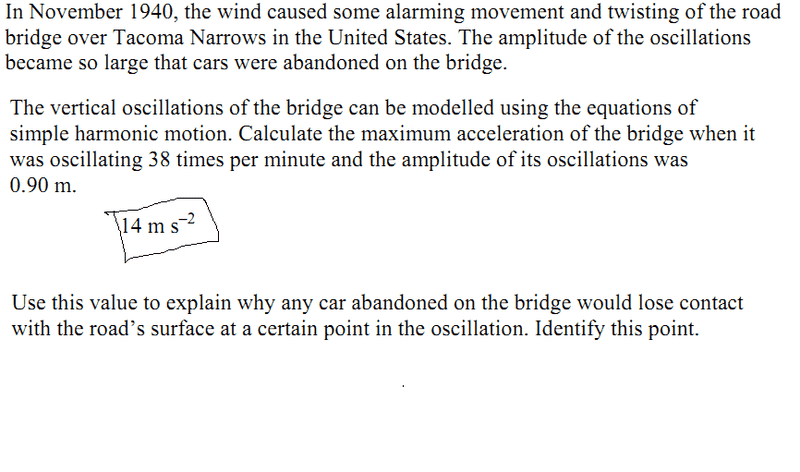

Oscillation - car losing contact with bridge
4 replies · 3K views
jsmith613
609
See attachment
Ok so as the bridge is at a point ABOVE eqm acceleration is DOWN and at some point ACC down is greater than gravity acceleration.
This is all true but makes no sense to logically. How could the car lose contact with the bridge at this point. Is the car thrown into the air, or does the bridge simply accelerate DOWN faster than the car
hi jsmith613! :smile:
jsmith613 said:
… does the bridge simply accelerate DOWN faster than the car
yup! :biggrin:
yup! :biggrin:
ok, trying to visuallise this.
I presume this will though, above eqm, as the bridge moves DOWN towards eqm??
