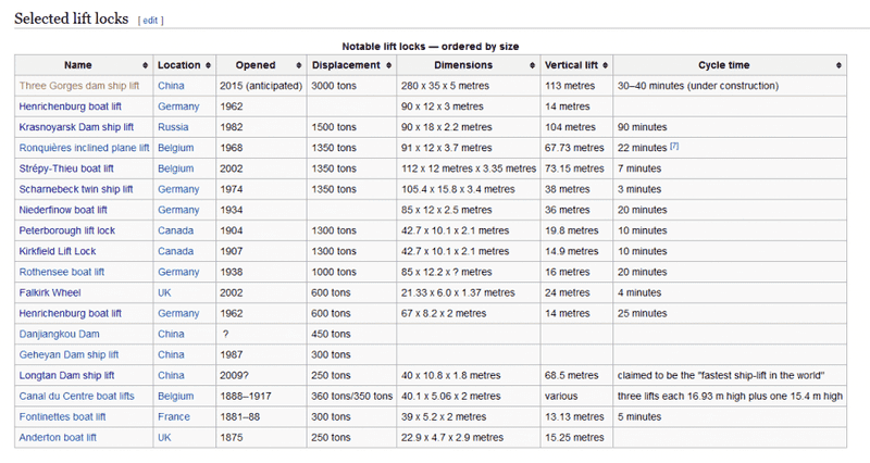

So my pondering comes from looking at these boat lifts :
1. Fallkirk wheel in Scotland :
2. Strepy Thieu boat lift in Belgium :
3. 3 Gorges Dam boat lift in China : Here are the details of each operation :
I see that Falkirk Wheel in the UK can raise 24 meters in 4 minutes; the Strepy Thieu 73 meters but it takes 7 minutes; but the 3 gorges dam in china takes almost 35 minutes to reach 113 meters?
So I was concluding that maybe it's the weight that makes the lift slower...but with 3 Gorges Dam it takes much longer just to go less than half of the Strepy Thieu lift?! I am guessing because of the power needed to slow down a weight that large (over 2 times that of Strepy Thieu).
One thing I was trying to figure out is this:
The Falkirk wheel takes 1.5 Kilowatt hours only to power one lift rotation 24 meters high but the weight is 1200 tons (about 600 each caisson) The Strepy combined weight is 15,000 tons (each caisson and water is 7500 tons). Does this mean the power for strepy is roughly about 36 times greater to complete the lift (15000 tons/1200 tons = 12.5 ; then multiply 12.5 times 3 to get 72 meters instead of the Falkirk 24 meter rise? So...for Strepy boat lift, the power utilized will be 1.5KwH * 36 = 54KwH ?
A little crude on how I deduced this...but is that a fair approximation?

When you're talking about displacing water, then having slow accelerations becomes critical. You don't want to create waves inside the containers.
First, kWh is a unit of energy or work, not power. Power would be energy/work per unit time (kW).
The work done is the force times the displacement (Strepy case) or, in rotation, torque times the angular displacement (Falkirk case). The force/torque here is the one represented by the friction, which is dependent on the weight somehow. Does the other friction characteristics compare one with another? That is hard to tell just by looking at the lifts. But if you were comparing 2 boat lifts of different sizes with similar construction, your assumption would probably be right.

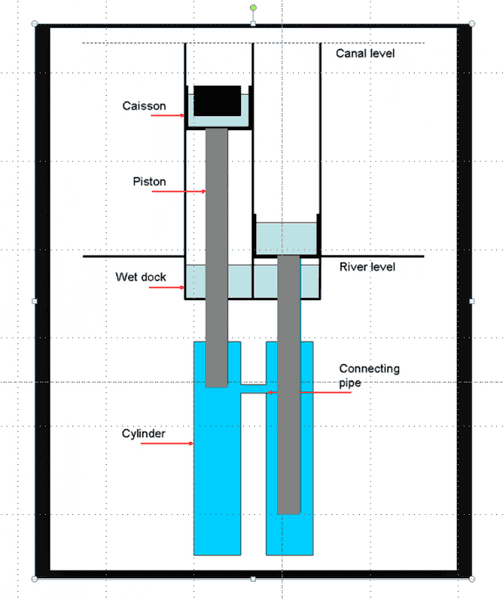

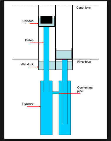

Thanks for all the great input guys! Another angle I was thinking about:
The Anderton Boat Lift in the UK is not using a Pulley System of Counterweights but the Hydraulic system using cylinders and pistons. These are my questions on the system:
1. Isn't there less friction since there is no weight on the pulley wheel; only friction on the seals and accounting for viscosity?
2. No need to add power to account for increasing rope length on the lower counterweight?
So given this -- if we used this system raise equal mass on each side by 24m (like Falkirk) - would it be about the same or just slightly lower than the 1.5 Kwh of energy to run this one turn?
Viscosity may be more important than one might think. We're talking hydrodynamics so pressure drag and skin friction applies.
I'm not sure why we're talking about power. I'm no expert on the subject, but the only boat lift I saw was the one in Peterborough, Canada:
Wikipedia said:
No external power is needed: the lift lock functions by gravity alone using the counterweight principle. One caisson always ascends and the other always descends during each locking cycle. When one caisson reaches the top position, it stops 12 inches (30 cm) below the water level of the upper reach, and the control valve is closed; Siemens ultrasonic sensors are used to help determine the differential. The upper reach and top caisson gates open, and water flows into the top caisson until the level equalizes. The weight of the extra foot of water is 144 short tons (131 t), making the total weight of the upper caisson 1,844 short tons (1,673 t). Any vessels that just ascended in the top caisson exit into the upper reach, and any new vessels making a transit of the lock then enter the bottom or top caisson from the lower or upper reach respectively. Once the vessels are secured, all gates are closed and the crossover valve in the connecting pipe between the ram shafts is opened. Since the upper caisson weighs more than the lower caisson (1,844 vs 1,700 tons), it pushes down on its ram, forcing out water from its shaft via the connecting pipe into the shaft of the bottom caisson. The force pushes up on the bottom caisson's ram, raising the caisson up to the top position. When the gate of the newly descended top caisson and lower reach gates open at the bottom, the extra foot of water flows out and equalizes with the water level in the lower reach of the canal, and any descended vessels exit, allowing the cycle to start over again.
And this system works since 1904, in a place with cold winters. Why other boat lift designs choose to use motors instead of gravity is beyond my understanding.
