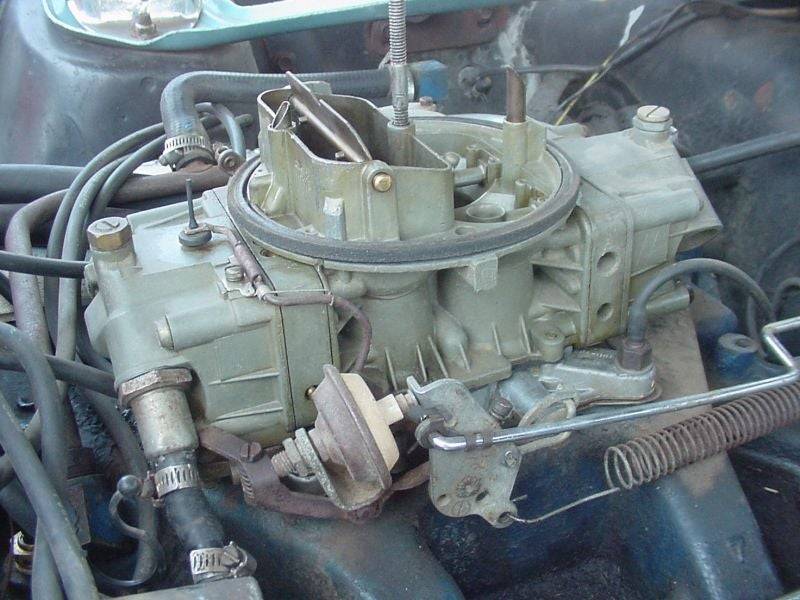

DaveC426913 said:
Oh. Its a shock absorber, just like in an auto suspension. Why didn't you say so?
If you use an automotive reference, use an appropriate one: carburetor, as mentioned by @sophiecentaur .
It was used to prevent stalling when the throttle was suddenly let go.

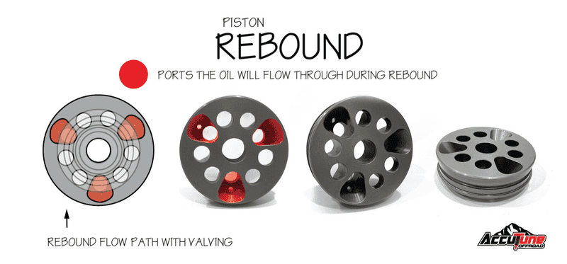

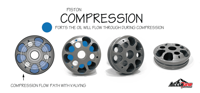

DaveC426913 said:
I did.
Shocks in autos have a slower rebound (re-extension) rate than the compression rate by varying the flow of oil through the piston head - just like the pashdot brashplot smashalot thingy the OP mentioned.
View attachment 360032View attachment 360031
Yes, but shock absorbers are meant to reduce vibrations, not softly stop the closing of something.
