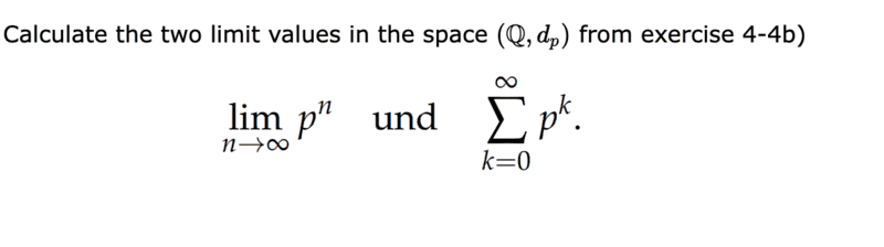

Calculate the following limits ##\displaystyle{\lim_{n \to \infty}} p^n## and ##\sum\limits_{k=0}^{\infty} p^k##
none
Hi,
I'm not sure if I have calculated the task here correctly

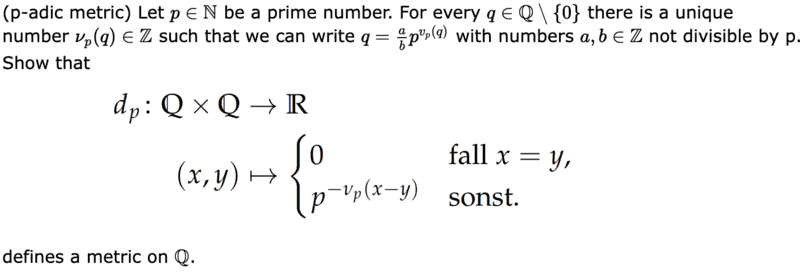

Task 4-4b looked like this
I have now obtained the following with ##n=-v_p(x-y)##
$$\displaystyle{\lim_{n \to \infty}} p^n= \infty$$
$$\sum\limits_{n=0}^{\infty} p^n=\frac{p}{p-1}$$
Is that correct?

a) What is the distance between ##p^n## and ##0##?
b) What is ##\displaystyle{\left(\sum_{k=0}^\infty p^k \right)\cdot (1-p)}##?

Regarding a)
Isn't the distance calculated as follows? ##| n-0 |_p=| p^n |_p=p^{-n}##
Regarding b)
##\sum\limits_{k=0}^{\infty} p^k \cdot (1-p)=1##
Lambda96 said:
Thank you fresh_42 for your help 👍
Regarding a)
Regarding b)
a) Yes. And if ##n\to \infty ## then ##\displaystyle{\lim_{n \to \infty}|p^{n}|_p=\lim_{n \to \infty}p^{-n}}=?##
b) Yes.

The limit value of ##\displaystyle{\lim_{n \to \infty}} p^{-n}## should then be ##\displaystyle{\lim_{n \to \infty}} p^{-n}=0##
Lambda96 said:
Thanks again for your help fresh_42 👍
Yes. The distance between ##p^n## and zero in the p-adic metric goes to zero.
